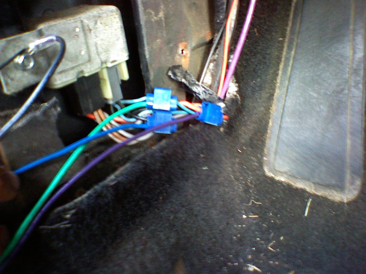

Ok, I do have the same system as you did and I was able to successfully install it (both the remote start and power lock) today. In the Power Lock Instructions, our cars have Type A lock mechanism. The three wire setup. You only have to connect three wires from the kick panel relays. The color of the three wires are light-blue, orange, and black... let me know if you need help or have questions...
Attached Thumbnails Remote Start/Locks ??-kick-panel.jpg
