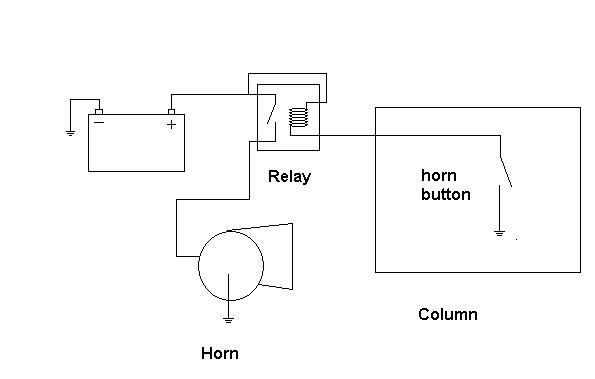

I need to install a horn on my 84 Z28. I have the horn but i don't know squat about wiring. any help is appreciated.

OK, i'll draw a diagram in paint and post it in a few minutes.

Re: How do I install a horn?
There you go. Let me know if you have any questions.
