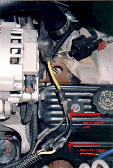

Just for the record I thought I'd post a couple of pictures. One of a burnt fusible link and the other one after it's been repaired.

If you look at the first picture you can tell that there was a considerable overload condition from the source (alternator). There are three fusible links connected to the alternator's output wire. Those links are what saved the vehicles wiring system. They're all probably in need of replacement. The farthest right wire looks fried,The middle wire is questionable and the third wire has had it. You would never use a fusible link in the interior or trunk of the vehicle because when they go they can be somewhat spectacular with smoke and possible fire...sparks anyway.
