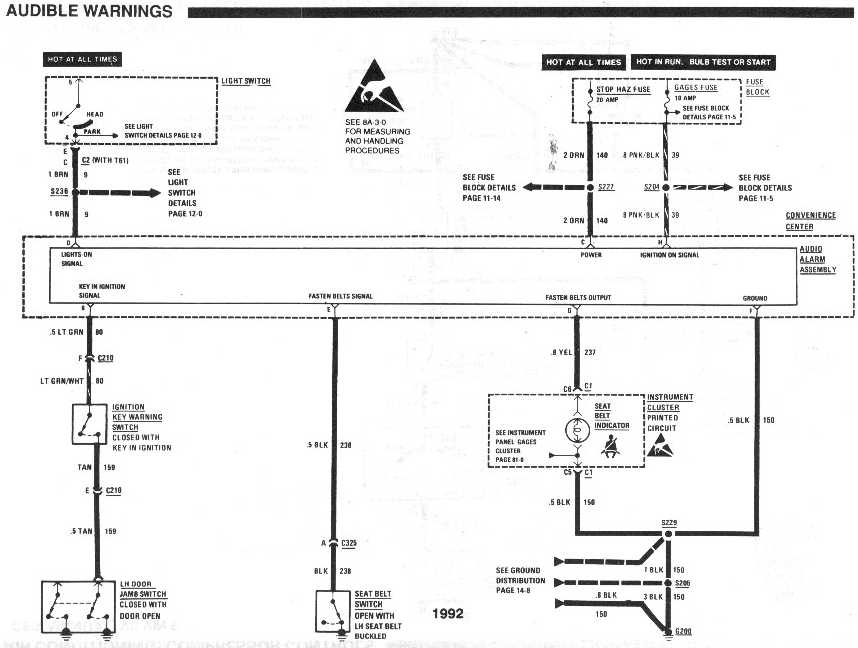

yall`know the buzzer that come on when you leave your lights on well when im driving and i turn on my lights the buzzer comes on and when i turn off my lights it goes off anyone know were that buzzer is located so i disconnect it and try to trouble shoot it

The door chime module is located in the "convenience center" under the dash, to the right of the steering column.
You can use this diagram to test the signals on the wires to determine which one is wrong.
http://www.austinthirdgen.org/mkport...e_warnings.jpg
I would venture a guess that the wire from the key cylinder is sending the wrong signal.
