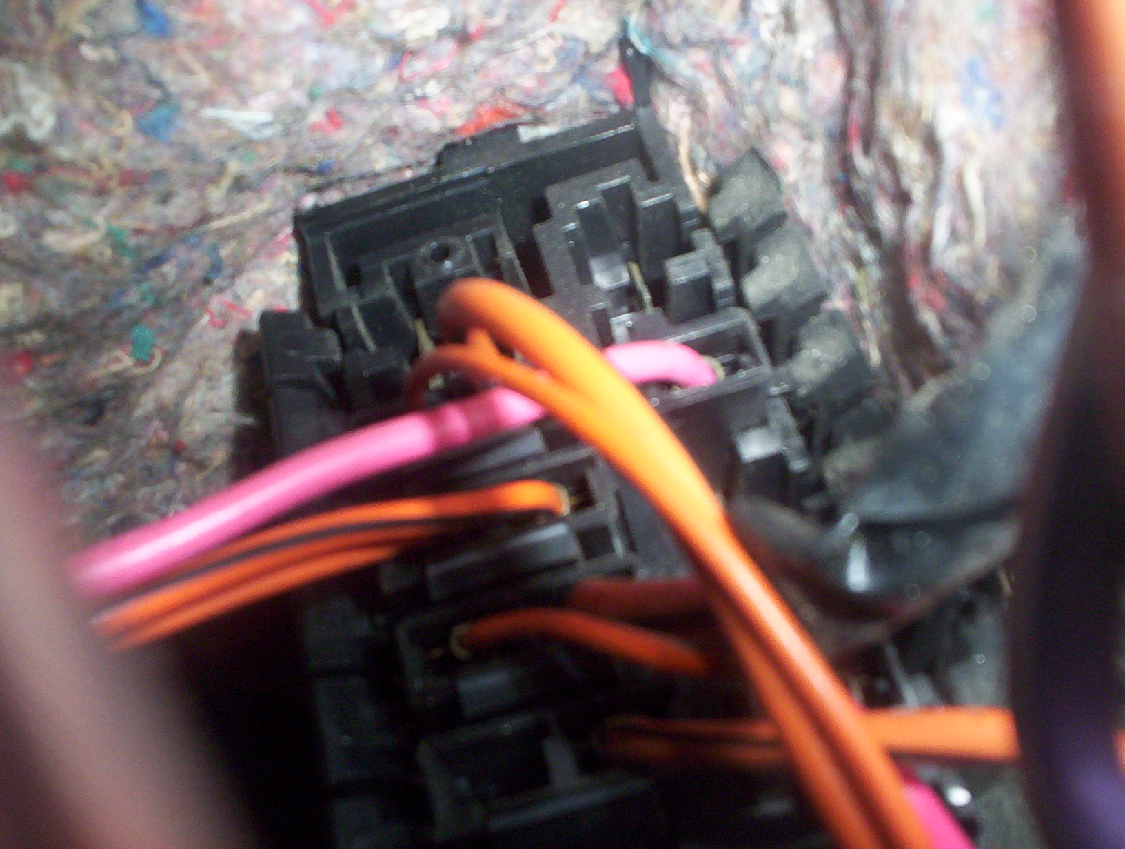

Hey chevy, do you have those pics? I'm workin on the same project and can't seem to find the junction box to plug into.

sorry guys, was gone for a few days, here's the pix of the junction block

thanks for the pics, hmm, definitely don't have that. I must have the newer wire setup... not cool.

those are out of a 1985 camaro, its the power accessory junction block, you should have it, its not very easy to see

They changed the way they did it in 89, got rid of the distribution box for a much more simple setup. I've searched for an hour and definitely don't have it. And my car was made 1/2 way though 89, so I am assuming I have the second setup.
