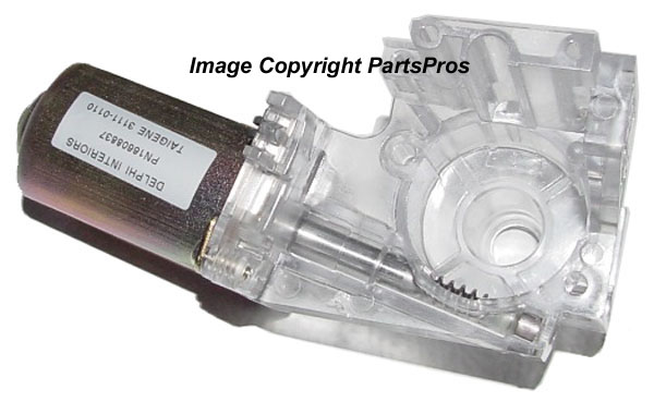

The pull down motor housing is plastic and is very commonly smashed beyond repair. This is an unfortunate byproduct of slamming the 3rd gen hatch
Good news is several companies sell new housings and rebuilding them is simple

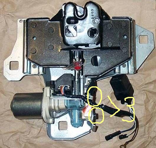

Pull down motor and housing

isnt that at the bottom of your lock?

This is what is mounted to the body of the car. The clear plastic is known as the housing. Note that the other member stated that the housing always breaks because of slamming the hatch, well this is one the parts that breaks, other than the gears stripping. Yes, its just below that latch. If your going to fix the pull down hatch area, then you should get the whole kit which includes a re-inforced housing, plastic guide sliders, gear nut, everything bro. Let me help you look for it. hold on.

Here you go bro, just the website that you need. http://www.hawksthirdgenparts.com/ha...omponents.aspx

No, the lock itself is riveted to the body between the tailights
The latch is ontop of the motor and rides it up/down the tracks. The metal piece bolted to the latch with the cable is the remote release solenoid

yea thats what i ment

Ok. the housing fell because your either missing 3 bolts that hold the housing together with the sliding plate (also you'll need new nylon guide/sliding bars), or the bolts broke right at the yellow arrows thus having no support.
Attached Thumbnails having some hatch issues-user103514_pic11592_1268445361.jpg

Probably a broken motor housing... Happens a lot. Look on the TDS site for one. Try to get a reinforced one if you can, and get the gear nut at the same time.

Yes sir. you should be able to see any threads here that are exposed in the yellow area. The housing is broken here in the yellow. Thats the MAIN section that holds your motor housing to the slider base. Compare yours to the other. The number 3 means that here goes the 3 bolts that hold your housing to the large plate that allows the whole pull down assembly to slide up and down.
Attached Thumbnails having some hatch issues-user103514_pic11595_1268446900.jpg   having some hatch issues-202280front.jpg

Originally Posted by evilemokid94
okay, so is there any way to close my hatch so i atleast dont get any water in my hatch area anymore?
Buy the parts and fix it....The repair dose not take rocket science skills. Three major parts:
1) Motor assembly
2) Dr gear
3) Nylon sildes
Also download the repair instuctions from Topdownsolutions....
