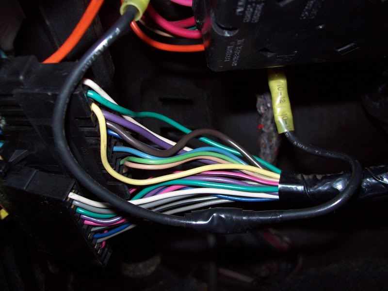

What is this wire?
My car has had a few wiring problems ive fixed myself. This one im not so sure about. One of the previous owners had the alarm taken out very sloppily and just clipped the wires and left connectors hanging which gave me starting problems before. This wire comes out of yellow wiring or yellow crimp connectors not sure what it is. But under the tape its just bare coil thats twisted together. Was wondering if anyone knew what this thick single black wire was for?

Judging by the gauge of the wire, I'd say that is the yellow wire that runs to the neutral safety switch or the clutch switch for your starter. And yes, I do agree that is a real hack-job.

Do you think that this would affect my cars startup in cold weather at all that the coil doesnt have proper insulation?

judging by the gauge of the wire it has something to do with the ignition system.
Whether is was a starter kill or some other kind of patch in for the aforesaid alarm.
Check it for voltage with the car on and off.
Reference to where it actually connects to will help.
These older cars could have wires patched in all over the place and we wouldn't know.
The yellow butt connectors really tell us nothing.
