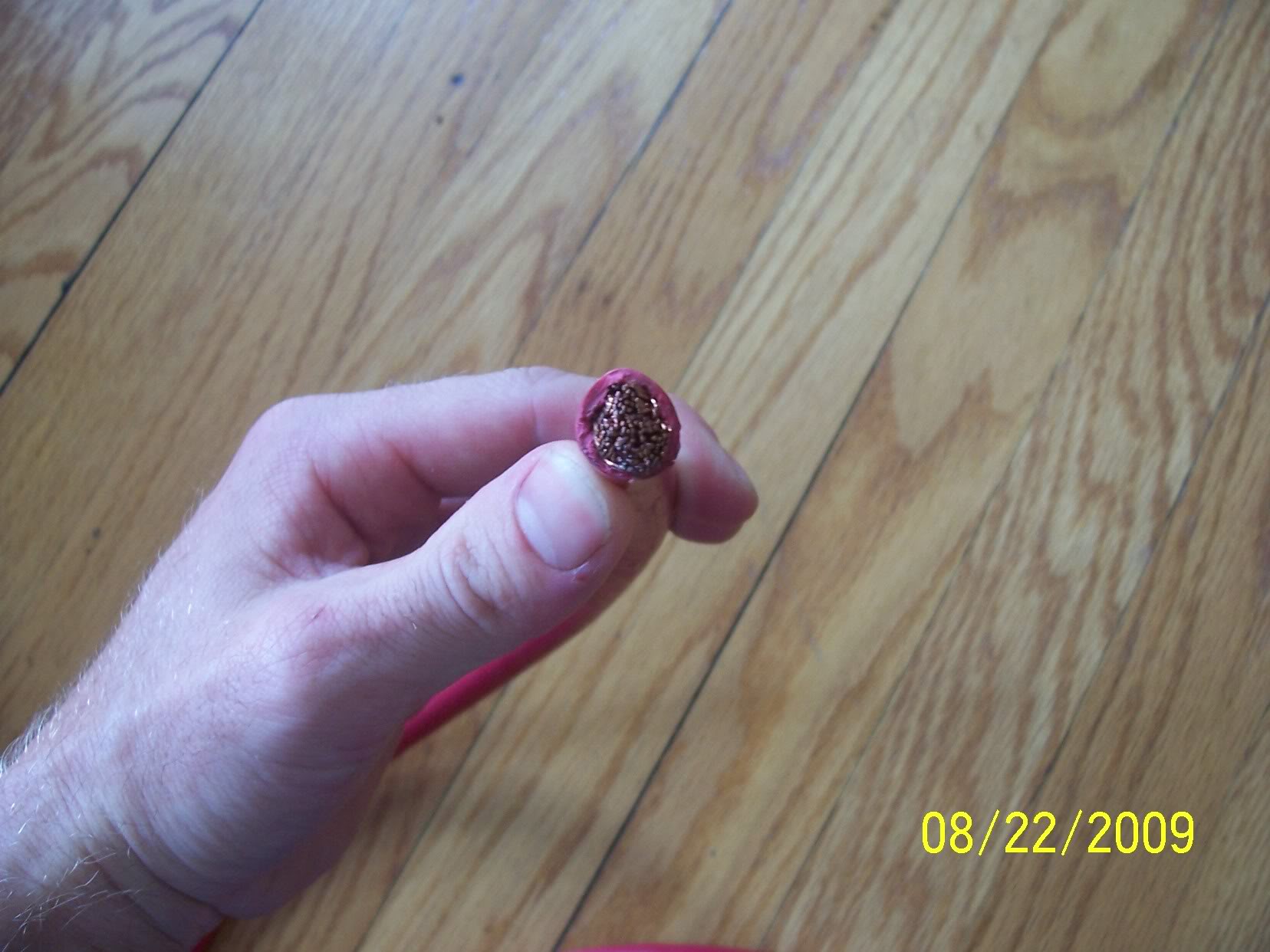

Stock routing. Edelbrock headers and Y pipe. Are you saying heat shielding wrap on the headers and/or starter?
It's 1 gauge wire from this kit.

Assuming that your connections are clean, that wire is fine and the additional 10' of circuit shouldn't be an issue. This makes me return to my first suspicion… heat soak. I’d try an inexpensive heat shield for the starter and see if that helps.
