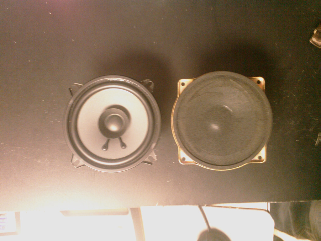

In my GTA I have the UQ7 performance sound and the subs were shot out and torn up when I got the car. So I replaced them with the ones from the fiero store, but when I push the button to turn on the amp the speakers sound distorted and basically worthless. What would be causing this? Could it be a blown amp or are the speakers not compatible with the amp, IE ohms to low? What would a speaker sound like if it's ohms were to low for an amp? I read that the system sounds pretty good from the factory and would like to have this feature back! Thanks!

The OEM Fiero sub looks to be exactly the same sub as the Firebirds used. If it's not the same part number, I'd be shocked. Just that the sound changes, indicates the amp is doing something. Distortion would tell me it's increasing the power output to the subs. Maybe try lowering the gain position or turning the volume down.

I would probably agree with you on it sounding like that because it's an 80's system, but it distorts badly when the gain is all the way down and the bass set at mid line with the radio barely on. If the radio was over half way or the gain was full on and bass turned up high I would agree, but this is not the case. I can't imagine Pontiac producing an obviously distorted sound setup like this and calling it performance.
