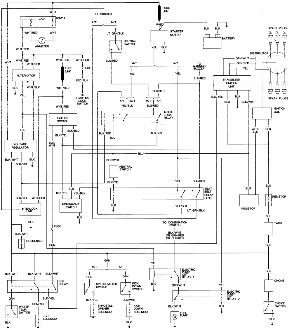

Hey guys. First, I wanna start off by saying this isn't on a thirdgen. However, this is the largest collection of automotive-knowledgeable people I know, so I figured I'd post the question here in addition to the car's proper forum. I wont say what the car is, but it's a 74 and it's carburetted, and the manufacturer rhymes with 'flotsun'. It's a customers car that I'm trying to get running, after sitting for 20+ years.
With a battery charger connected, I can turn the car on run, and the tach shows 1800rpm + (it moves around, but it's always above 1800rpm). The ampere gauge (yes ampere, not voltage) barely moves when I turn the ign to run, even though the charger is on 200amp START. If I stick a spark plug in the coil wire and hold it against the manifold, I get a constant, very hot spark. The car has a transistor-ignition module mounted on the wheel well, with points-elimination sensor (factory) mounted inside the distributor. The alternator is not currently hooked up, but from what I can tell in the wiring diagrams, this car has an external voltage reg. Any ideas? I'm stumped.

Ok not sure how much help I can really be as I havnt not worked with that particular brand but hey ill bite its an old car how bad could it be lol. First If you have any schematics you could send me it would be of great assistance to me to help you get to the bottom of things. now im not totally sure what your questions are but ill answer to the best of my ability and just let me know if im off base or missing the point.
First the tach. Without a good schematic I'm not sure what sort of a signal it requires to work. It may be that that is why its getting stuck above 1800 RPMs is due to a lack of a signal telling it to do otherwise. Could be a bad gauge or whatever drives the tach may be faulty but again for that I would really need some sort of a schematic to piece together what it should be doing and what it needs to work.

For constant spark, I mean just not intermittent. It actually looks to be about the amount of spark you would see at 1800+ RPMS. The tach is a single wire driven off the coil, and I actually think the tach is working just fine, but something is telling that coil to fire off constantly.
You explanation would make sense for the amp gauge, however, when I turn the car to run, it actually goes backwards into the negative (I just noticed this).
For the voltage regulator, I was saying that since the alternator doesn't have a voltage regulator, it shouldn't matter if it's hooked up or not; there seems to be one hidden in the car somewhere, at least according to the diagrams. The voltage regulator should hamper any crazy interference from the charger (but I've been wrong before).

Ok well I may have a guess as to whats going on here. My take is you dont have a battery in the car your just doing testing off the battery charger? The issues may be that electrical noise generated by the charger is triggering a false spark. See the voltage regulator regulated the voltage by controlling the output of the alternator. Since there is no alternator its essentially doing nothing but existing. However it was never the regulators job to deal with electrical noise like voltage spikes. That job is done by the battery as the battery essentially acts like an infinitely large capacitor shorting out voltage spikes (charging the battery) and providing current if the voltage dips to maintain the correct voltage. Without the battery in place your electrical system just gets the raw output of the charger unfiltered. Being the the output of the charger is probably not going to be a nice clean voltage this could be causing false triggers. That ignition module is looking for voltage variations (and is very sensitive) and could easily be mistaking the noisy output of the charger for a signal to fire the coil. I would try putting in a good battery hooking the charger to the battery and then trying it again. I wouldn't be surprised if that cleared it up.
Also yes a negative deflection is correct. Im assuming youve got the battery charger hooked up to the +/- battery cables. What it means is the car net current draw is being drawn from the battery resulting in a negative reading as its discharging the battery. If you were to put the positive lead of your charger to the output of the alternator (the white/red wire) your reading would be positive instead as the net current draw was coming from the alternator which would be charging the battery.
Also thanks for the schematics.
