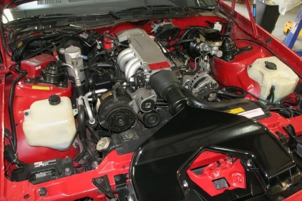

Re: Where to mount an ignition box??
I've got mine mounted on passenger side between the shock mount and the AC box. Name:  untitled.jpg
