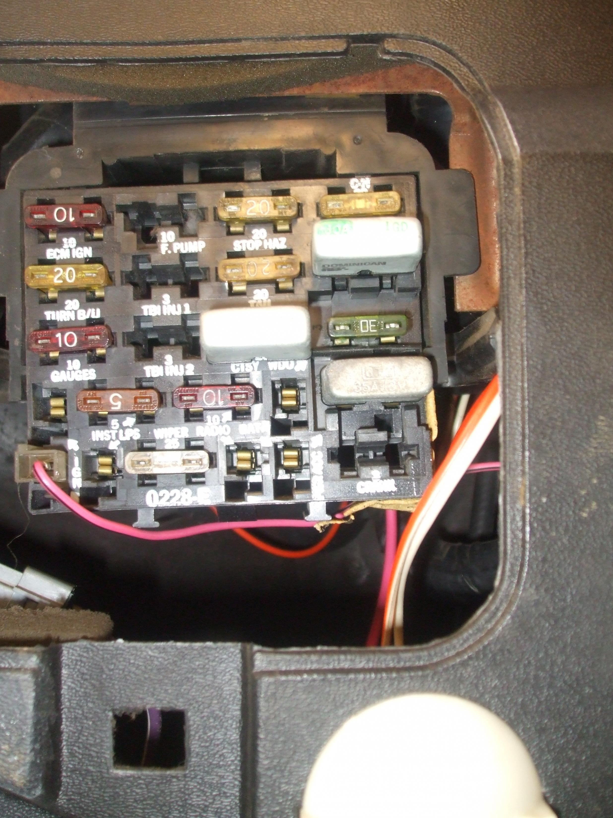

I recently picked up an 82 Fireird, and it will be my first project. My problem is this:
See where in the fuse box there are places for wires labeled ignition, battery, and radio. Well arent there supposed to be wires plugged in there? Because when i try to jump the battery, nothing at all on the car receives power. And the previous owner had a thing for messing with wires.

The4 factory gave us empty single slots for accessories - any standard 1/4in male spade connector will plug right in. The only places fuses are required is where there are 2 empty slots side by side (since a fuse has two prongs on it).
BAT is power always, regardless of key - nice for alarm power, electric seat power
IGN is power only when key is on, nice for additional lighting, etc.
RADIO is power when radio is on, nice for external CD decks, etc.
Some cars also have LPS - that's power when the lights are on.
