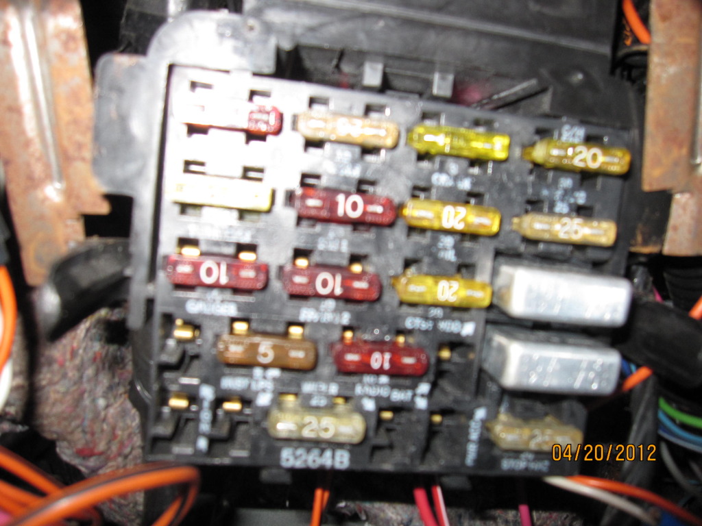

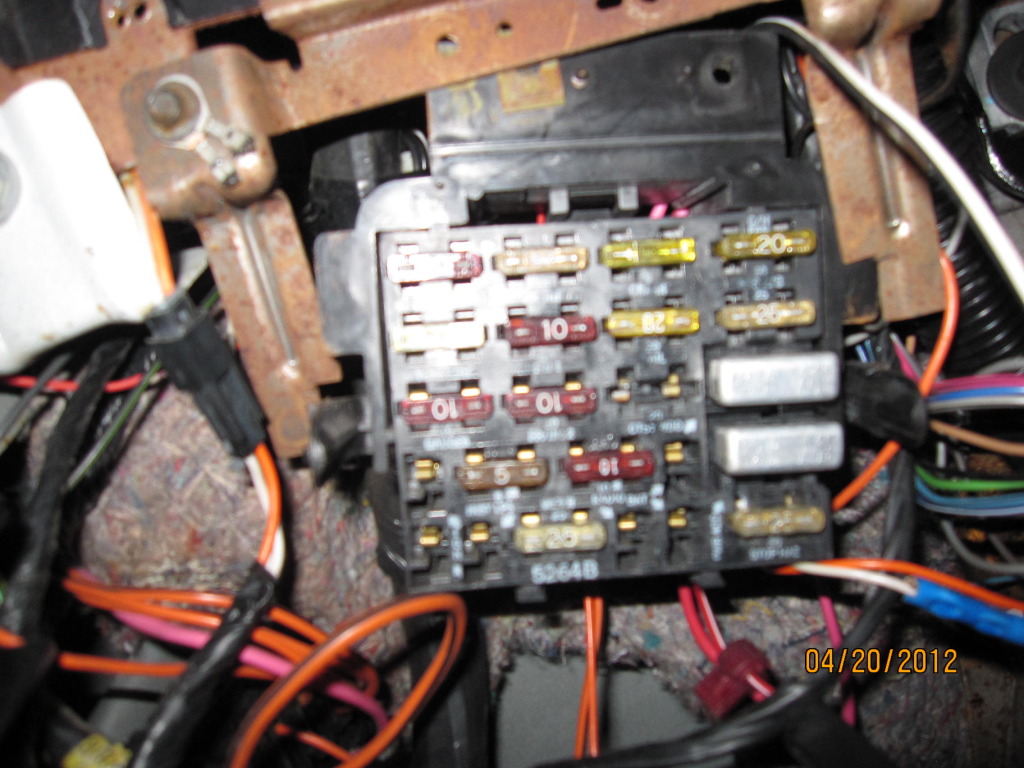

Well I finally got my 87 TA running once again and its now time to fine out why my battery dies after 3 days. I have been told that it is connected to the 20A fuse. I wil attach the fuse installed and removed in question. Can someone point me to the areas that I should be looking at.

Its the fuse nearest the large silver fuse. Also this fuse ties into the under dash lights, when the fuse is pulled, the lights go out, naturally.

Should be a 15A... Look for a light grounding out, be it the dome light, rear cargo light, radio wiring, power locks, or even the lighter socket. That's the CTSY fuse, for all of the "accessories" except the power windows (circuit breaker).
