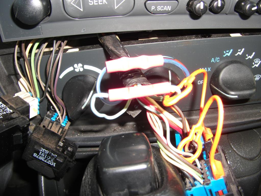

Okay, I probed the male/female connector coming out of my steering column. and based on your diagram my car has the same color wires specific to the turn signals. Using a test light wires related to the right turn signal front and rear cause the test light to flash. Wires related to the left turn signal front and rear only stay lit solid.
So I guess this means the problem is else where in my harness.
The making better contact of my ground wires at my tail lights also resulted in the cruise control working again and one thing I failed to mention was the ABS inop light was on as well. Odd as it sounds that no longer comes on but ignition on turns the abs inop light on for a bulb test.
I am going to check the DRL module later this week and see if it is the culprit and probe the L/F socket better and try the same clothes hanger thing I did on my tail lights. If I have to I will just replace all the sockets but I just see no wiring issues anywhere on the car. All light body grounds are tight.
I will probe the bulkhead connector and see where exactly this light blue wire loses power. The DRL module seems to be priced cheaply and my car is subject to the conditions the TSB mentioned since I use my a/c a lot usually every day.

Well I came across a 1997 camaro wiring diagram and where your diagram shows the wires coming out of the turn signal going directly to the turn signals. This 1997 diagram shows the wires from the turn signal switch but instead of going to the turn signals on the front, they go into the DRL module first.
So I am wondering if this is the heart of my problem.

Well, I got the drl module out of my car. Pretty simple to do since it is right behind the radio. I have no sign of corrosion at all. I opened it up and it looks brand new inside.
When the pigtail that holds the front turn signal wires is removed the right turn signal does exactly what the left has been doing. I'm going to try and put power to the L/F output wire and see if this will light up my L/F turn signal.
Apparently this module is 370.00 at GM I went to GMpartsdirect and it is around 230.00 there.
Wonder if applying power to the L/F signals wire works if the input and output wires can be spliced and if this will bypass the DRL while still keeping all of the modules other functions. Simply unplugging it makes matters worse by the way and other stuff stops working on the car.

By jumping the lightblue/white stripe wire coming from my turn signal switch to the light blue wire from the drl module that goes to the L/F turn signal it will flash.
So my DRL module is without a doubt bad. I'm going to pull the terminals out of the DRL module pigtail and connect them together and see if that will just bypass the drl control and still keep the other stuff working.
Old Nov 9, 2012 | 05:25 PM
Jeffs82TA's Avatar
Joined: Oct 2009
Posts: 809
Re: help on a 4th wiring issue
Here is all you do to bypass or get a front turn signal issue solved. I am not sure if this will work on a later or earlier model but this stopped my drl and turn signal issue but my automatic headlights still work.
Simply remove the DRL module and unplug the pigtail with these wires, then unpin these wires from the drl module pigtail (real easy to do) light blue with a white stripe and the light blue wire and connect them together. Then remove the dark blue with white stripe wire and the dark blue wire and connect them together.
Then plug the DRL module pigtails back in, this will bypass the daytime running lights and retain the automatic headlights and turn signals will work normally as will 4 way flashers.
Thanks for your help Maverick!

yes I used solderless connectors.
