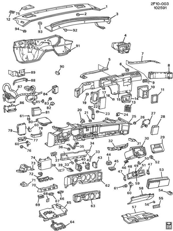

Re: vats again!!!!
where is the pass code box located on the formula?I got both driver and pass. panels off and cant see it.I've taken a firebird apart before but cant remember.above radio pod?
Old Jun 5, 2013 | 05:43 PM
Tuned Performance's Avatar
Community Influencer
iTrader: (95)
Posts: 16,937
Likes: 1,019
From: Mile High Country !!!
Car: 1967 Camaro, 91 z28
Engine: Lb9
Transmission: M20
Re: vats again!!!!
It's located behind the defrost vent(duct) area. It was not intended to be easy to get to. Start pulling the dash.

VATS module is located above the top left rear corner of the radio pod and is bolted to the center dash duct (in the pic above, the mounting space is above the numbers 15 and 16). Only way to get at the mounting screws is to remove the dash and the center duct. However, this will not stop you from merely disconnecting it to temporarily connect up the other module. The connector points down and towards the center of the foot well.
Bypassing the starter relay, to make sure the rest of the system works, is as easy as finding the relay and jumping the large YELLOW wire to the large GREEN wire. IIRC, the starter relay should be bolted to the dash support to the left of the steering column.
Also, might want to change the SECURITY light bulb in the cluster... Sounds like it's probably dead.
