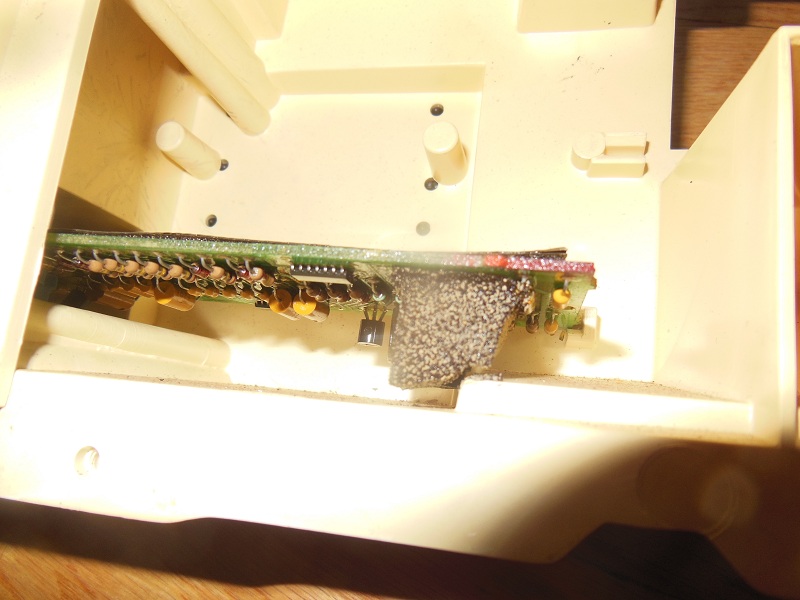

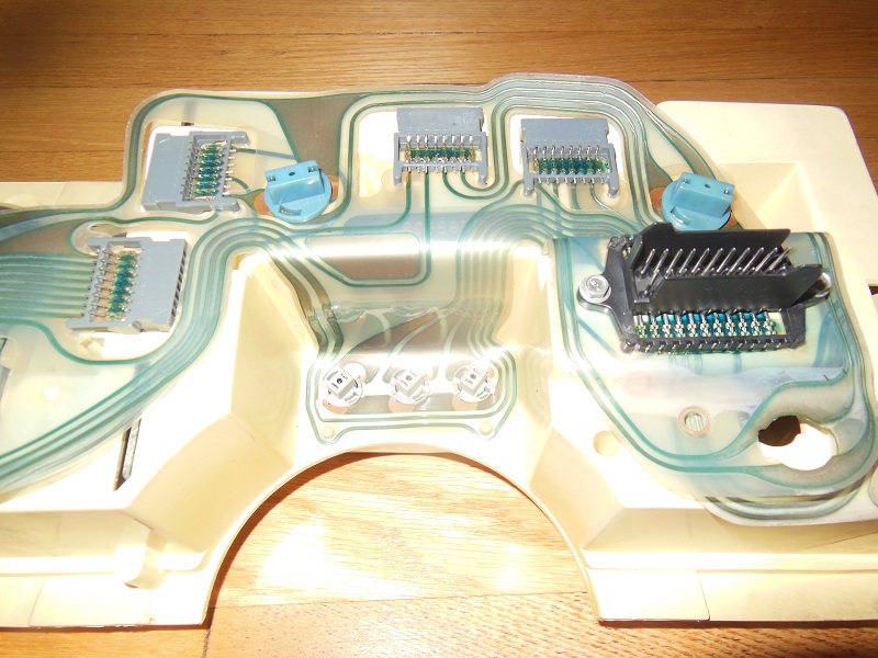

Hey guys, I took the dashboard out of the car, so here's some pictures of it.
The circuit board on the driver info panel looks like it has something peeling up. Is this a source of some of the problems, or is it just a cover for the board?
I am thinking about just buying a new dashboard assembly and steering column, because it might be the easier (and nicer looking) way to go.
Attached Thumbnails '87 GTA Digital Dash/electrical Problems-messed-up.jpg   '87 GTA Digital Dash/electrical Problems-d.-info-center.jpg   '87 GTA Digital Dash/electrical Problems-info-cent.-mo.-board.jpg

Just a few more pics.
Attached Thumbnails '87 GTA Digital Dash/electrical Problems-back-side.jpg   '87 GTA Digital Dash/electrical Problems-info-cent.-back.jpg   '87 GTA Digital Dash/electrical Problems-info-cent.-backinside.jpg
