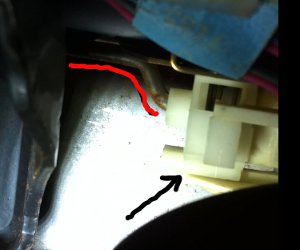

My high beams won't turn on either, and I'm working on that today. Here's a picture I took of the rod and the switch under the dash. The red line goes along the rod, and the black arrow points to the white switch.
I also took a quick video of the switch moving. Here:
I think my switch might be bad, as the rod is clearly moving. Maybe it's not moving far enough to engage the switch?

Looks like you've got enough movement to me. I'd check the switch with with a DMM, and the wires to the bulbs
