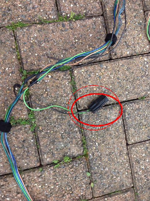

Hi Guys,
I'm still trying to repair the wiring mess in my 87 IROC and need some help with my light harness now.
Although its not in bad shape there are just a couple of things I cannot work out; (I cannot understand wiring diagrams )
1. Can anyone tell me what this connector is for? It connects (i Think) to the harness coming along the chassis rail near the fuel lines?

Black/green connector in first pic is for fog lights, looks like you don't have any from your avatar. Second pic looks like grounds, but I cant be sure from the way the harness is laid out and not in the car. There should be a ground on either side of the radiator screwed into the core support.

I do have fog lights they are just in a box in the garage at the mo lol!?
I am tryting to repair a small engine bay fire and subsequent wiring hack job by some PO. I pulled the IROC out of a barn where she had been sat since 2007 so she was in a real mess but we are getting there.
Trouble is im not very good at wiring and I cannot understand the schematics in the HELM manuals I have got.
Is it correct that the fog light connector plugs in to the connector coming from the harness that runs along the chassis rail near where the carbon canister should be?
