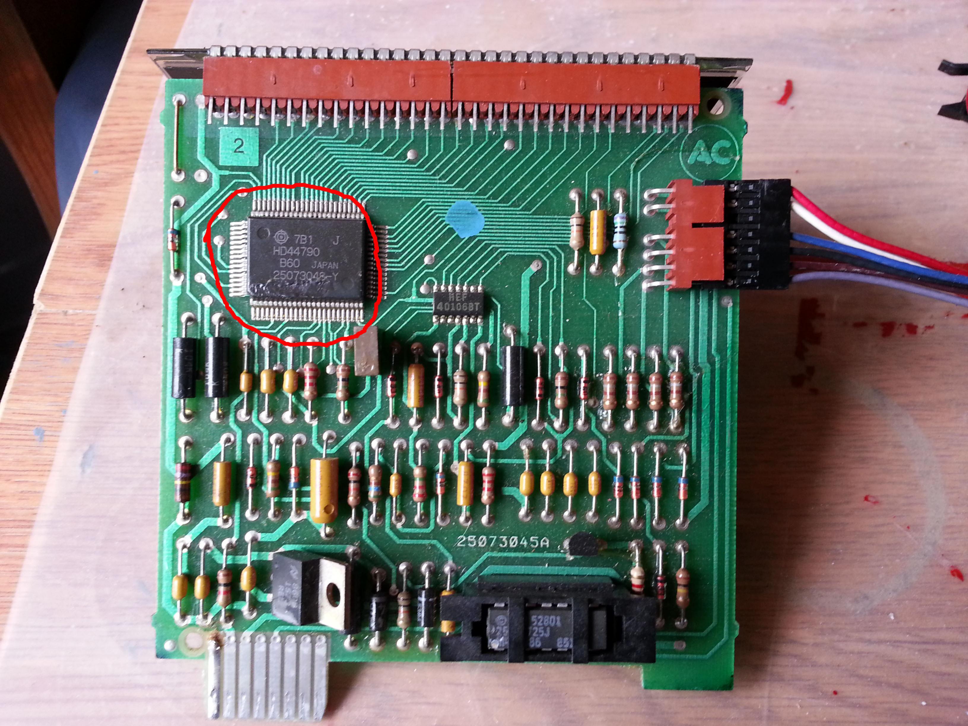

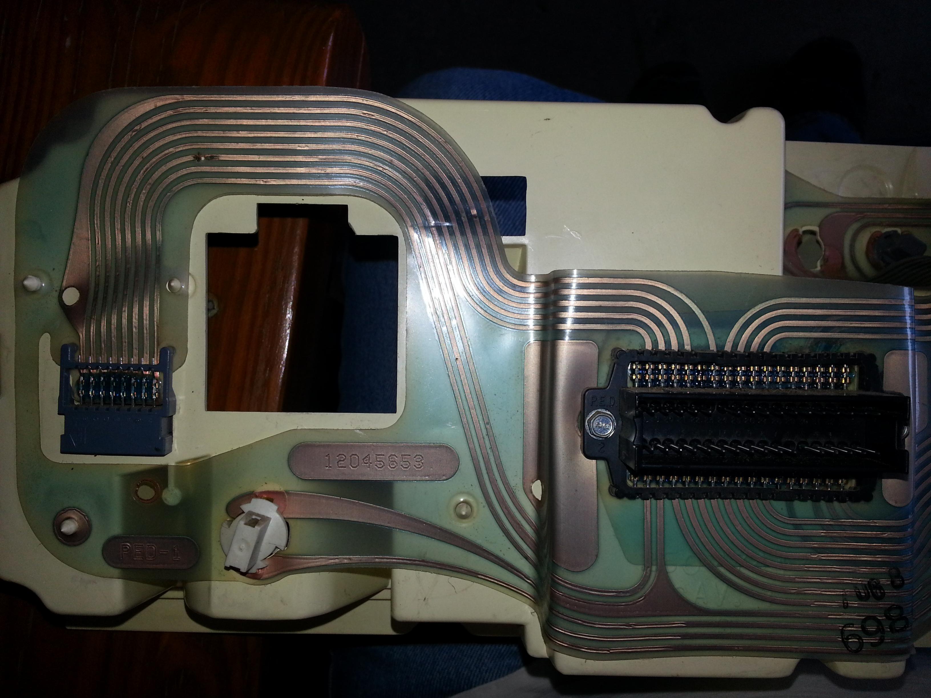

The digital speedometer in car "1" I'm trying to fix reads accurate to a speed of 35 MPH and then jumps all over the place. the odometer panel does not show anything. Believing that the odometer card was the problem I purchased a parts car with the same dash and tried putting the odometer card from car "2" into car "1". The card from car "2" would not work in car "1" I then took the card from car "1" and installed it into car "2" and it worked.
Now suspecting that the problem was in the speedometer cluster I took the dash cluster from car "2" and put it into car "1" this seamed at first to have fixed the problem as everything was lit up and working including the odometer panel and all the buttons to change the functions when the key was put in the run position.
I then started the car put it into drive and started to throttle up and this time the speedo read up to 23MPH and started to jump all over the place again, I looked over at the odometer panel and it was dead again.
After removing the speedo cluster I noticed the damage on the rear of the panels circuit ribbon and then looking over the back of the cluster from car "1" found it to have the exact same damage in the exact same spot.
I wish I would have looked over the cluster from car “1” before I installed the one from the parts car but I didn’t BAD ME !!!!
How I have 2 s****ed up clusters and still don’t know the cause of the problem. I’m now suspecting the problem may be in the odometer card. I traced the ribbon and it goes to the #16 pin on the panel which indicates that it is the ignition power from cluster fuse panel
I will try to up load a photo of the back of the panel.

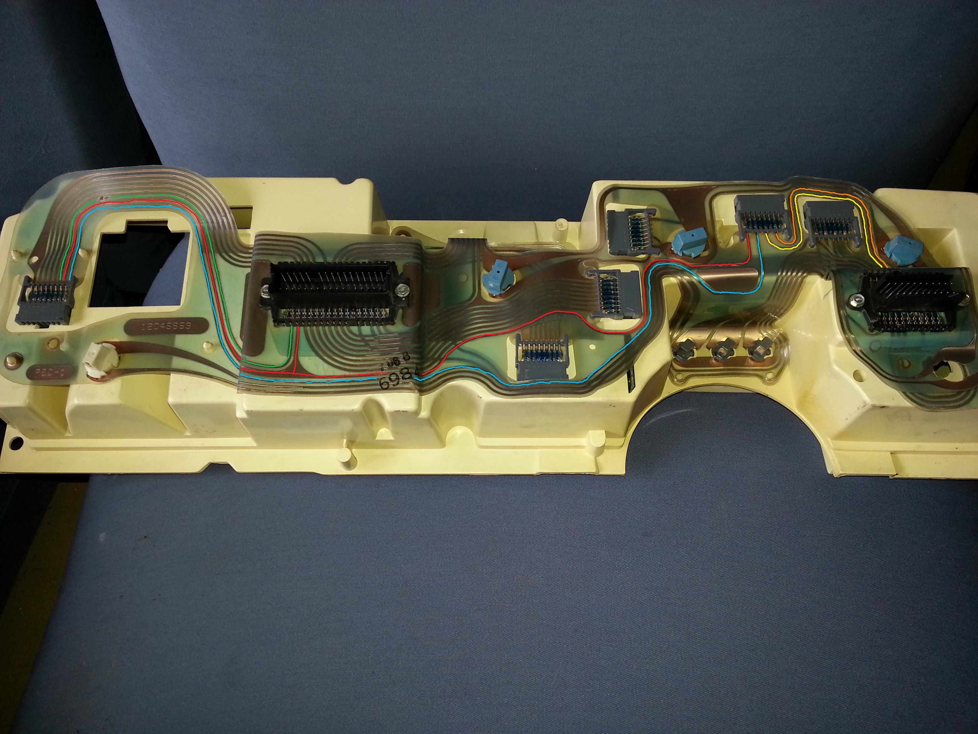

I hope this works
I hope this works
I don't KNOW that, but it seems reasonable based on your description. I would NOT install the card from the original cluster into ANY other cluster going forward,....... at this point I simply couldn't trust it !

At that point the original cluster/printed circuit was already bad I assume.
Seems as if the card itself "could" have caused the burnt printed circuit to the original cluster,... then to the second cluster once the original card was placed into it.
A friend has taken the cluster from car "1" to work where he has access to a insterment Teck who may be able to repair the ribin circuit and I found a company in Calgary AB. that was a repair shop for GM's digital panels. I sent them photo's of he dash and the suspect problems. i'm hoping they will help with this issue. I will keep you up dated. Thread Starter

I'm going to check the G118 ground wire as it seams to be common to both pin connectors in the dash, I looked for it yesterday but couldn't find it. I know it's located on the back of the passenger side head of the motor, but haven't figured how to get at it. I hope I don't have to take all of those pipes out to check it.

did you ever fix this? my odometer is also not working and i assume its the card. when car starts for few seconds it shows up and then fades. odometer is lit up but no digits on it. i changed dimmer already. also car does not record mileage when driven. makes me think odometer circuit board is bad. i started looking for a new dash to replace it. (noone sells the card). It would be great if someone figured out the fix for this. I read a ton of posts both here and on gta sourse with ppl having same issue. noone seems to have the answer.
Joined: Jun 2012
Posts: 114
From: Howard County, MD
Car: 1987 Trans Am GTA
Engine: Warmed over 350 TPI
Transmission: 700r4 soon to be t56
Re: 1988 Digital dash problem
I replaced the odometer circuit board. But I swapped the mileage chip with my original. If you want to keep your original mileage, you'll need to do this. I can take a pic of what I am talking about if you want.
Joined: Aug 2008
Posts: 132
From: New York
Car: 1992 Z28
Engine: 350TPI
Transmission: 700R4 Auto
Axle/Gears: G92
i figured that out but thank you. now i just gotta find a digital dash with working odometer circuit board.
