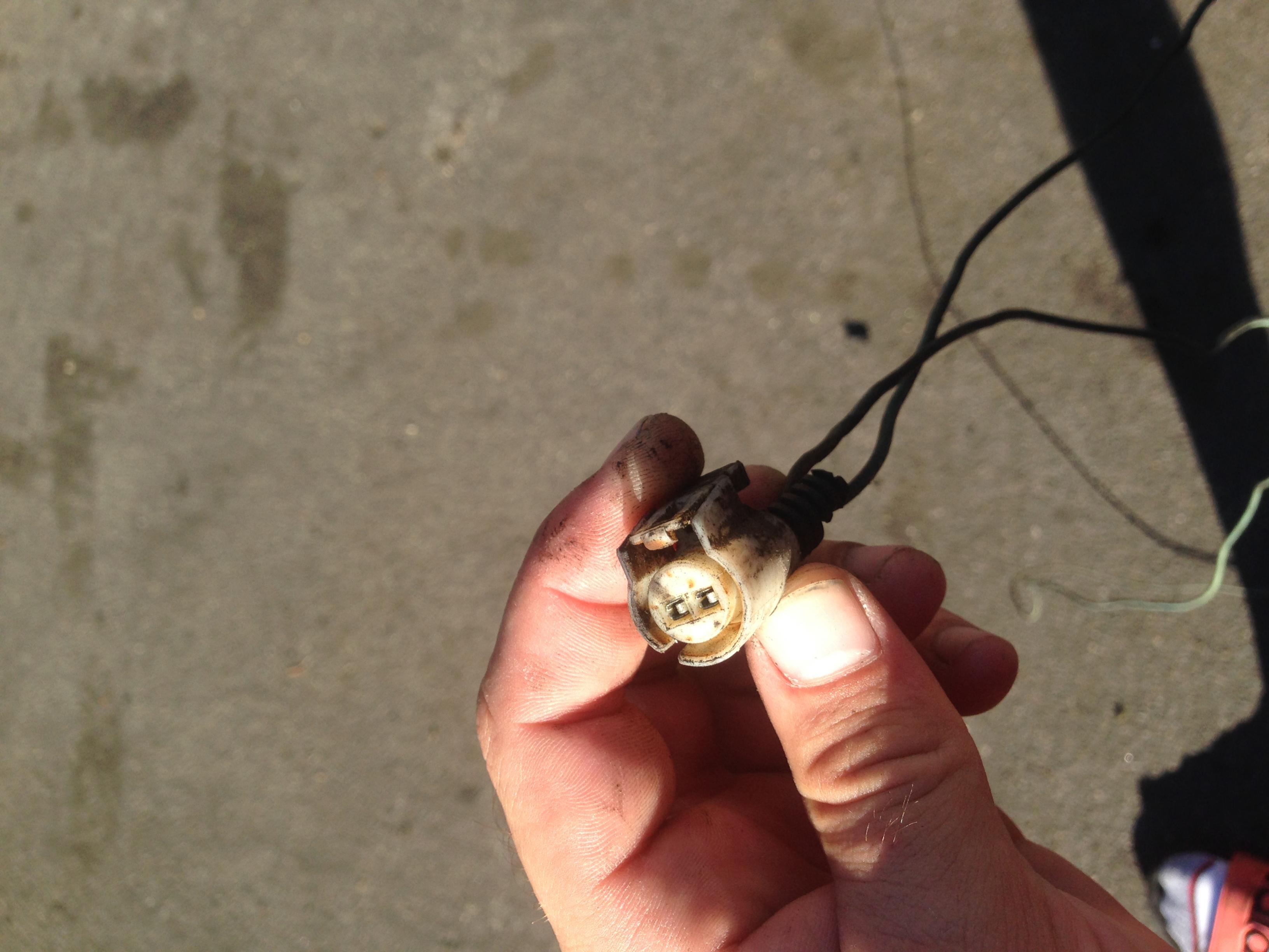

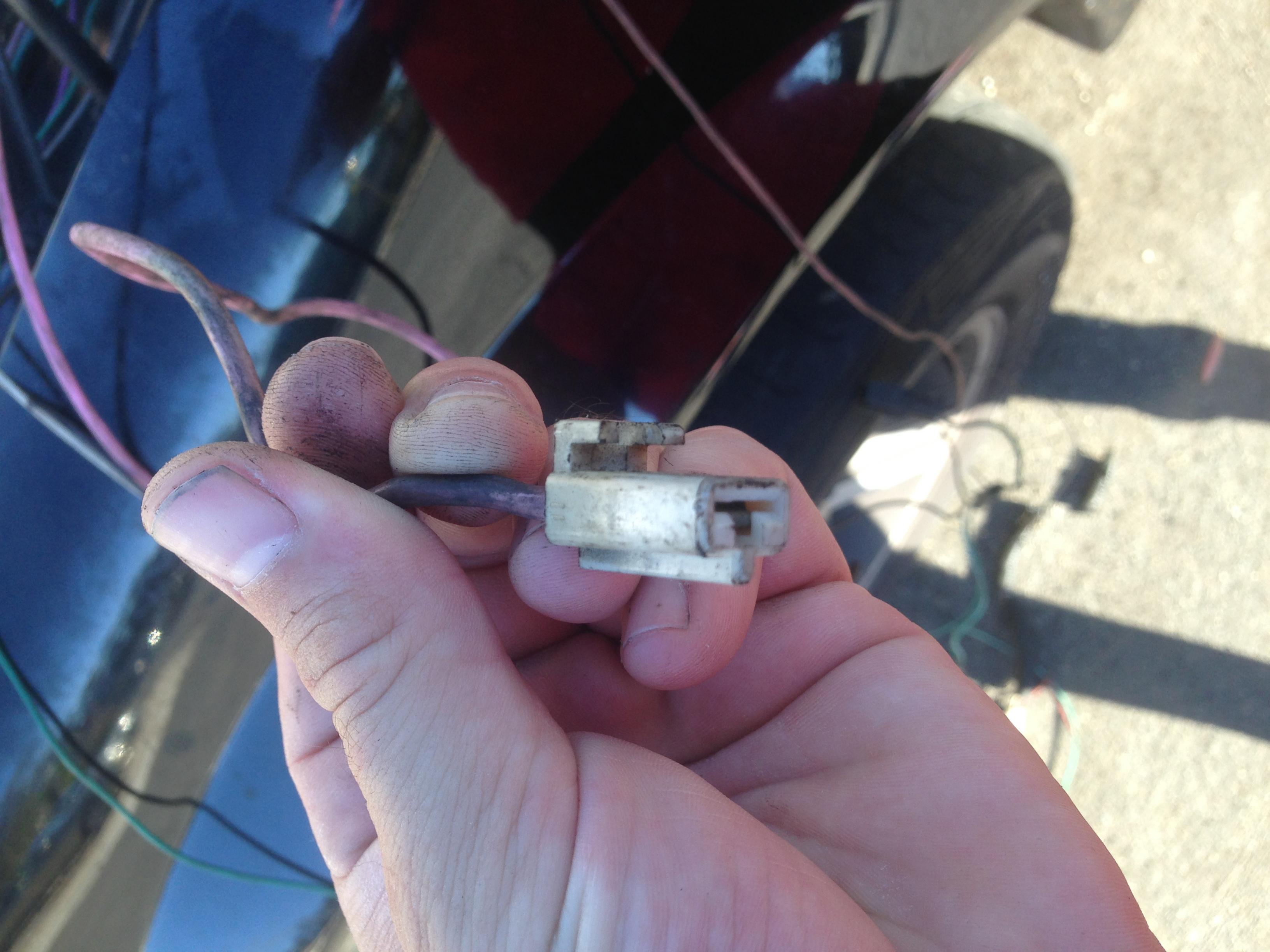

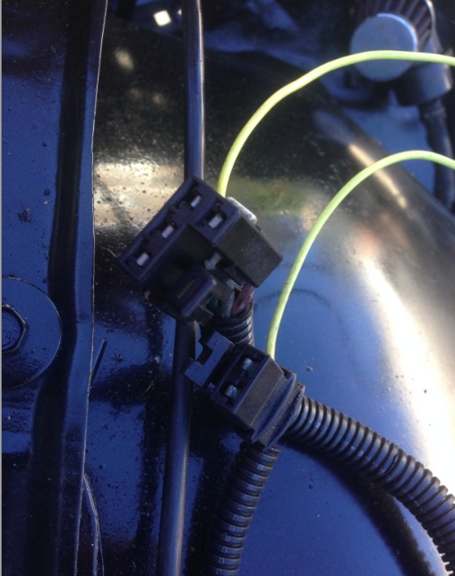

i have a 85 iroc with no engine but all the wiring. I'm trying to find out what each of these terminals plug into. i have looked at all the austinthirdgen diagrams and none of them are the same as my c100. it will be easier to pinout if i can find out what connectors are what. thanks in advance for the help

last two. these are connected by a yellow wire

First is ign hot to dizzy second is tach third I think is high pressure switch for AC

Last two are the wiper motor

thanks a ton. you just saved me a bunch of time!
