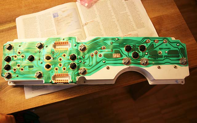

Re: dash lights
Then there is the cluster, the bulbs are located in those sockets that can be unscrewed easily. I actually replaced only the ones that light up permanently. I left the original bulbs for the turn signals, headlights and idiot lights as when replaced by led's they made some strange blinking and that awful beep came on too. I think you'd have to replace a relay to get it to work properly, maybe someone can chime in on this.
I believe I replaced the bulbs in the grey sockets only
These are the original wedge base bulbs with the orange caps on the 91 bird:

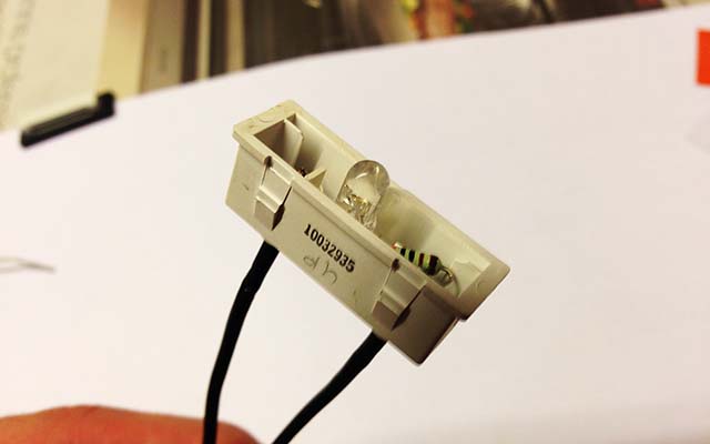

Then there is that weird light that illuminates the switches to the left:
I carefully pried it open
I soldered in a neutral white LED and a resistor
and I replaced the orange film with a clear one
I don't remember the resistor I used, anyway you'd have to try out. Mine is actually a little bright.
