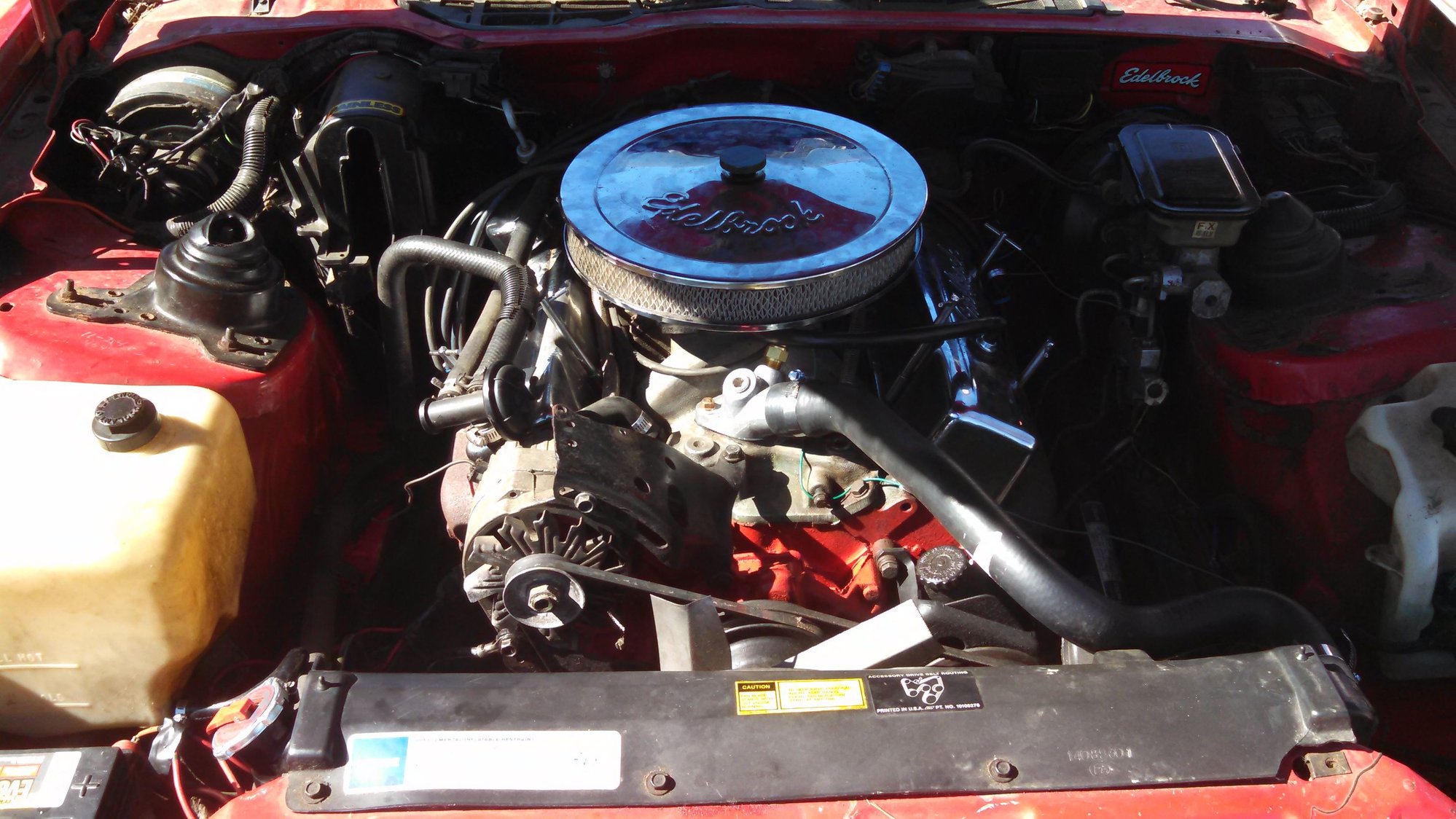

Hey guys, I have a 1991 firebird that was a VIN E 305 car with 700r4... A nice humble refreshed 350ci sbc was dropped in it and it runs pretty great!
Except the other day, the volt gauge in the interior started reading 8-9v... I took out my multimeter and read the battery, it gave me a reading of 12.56 and dropping, .55,.54. So naturally I ripped the alternator out

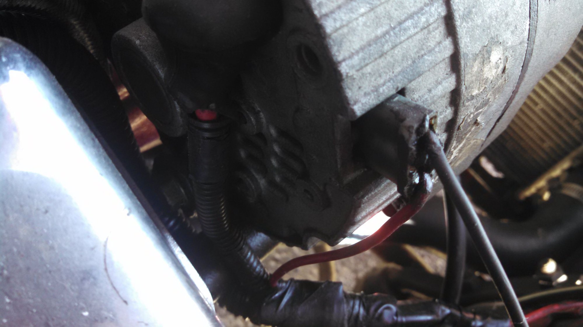

Which leads me to the... Uh *cough* "Wiring" where I'm now 100% sure the problem lies,

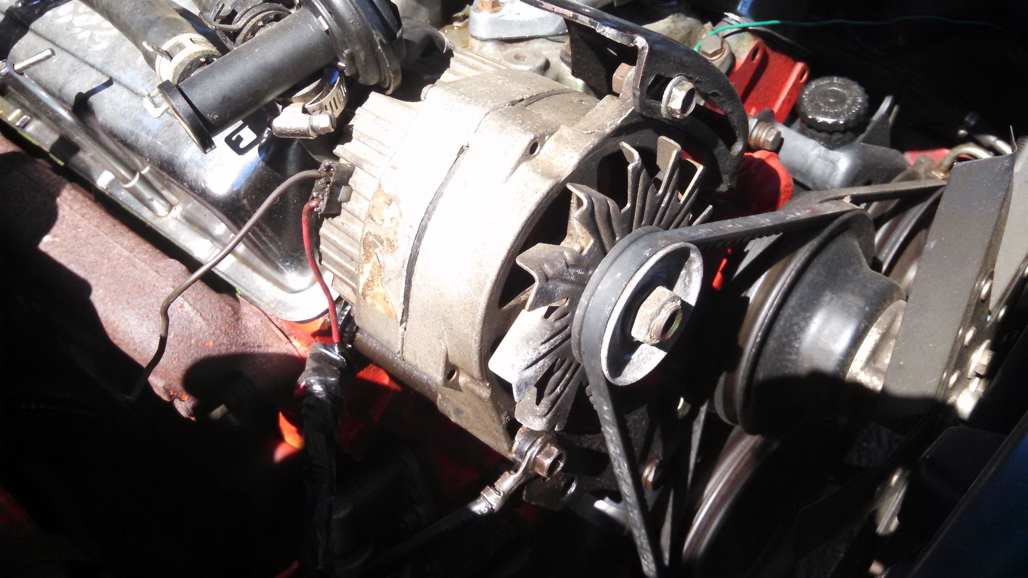

So besides the obvious, replace that dual female blade connector and splices, how should I wire the alternator to the car? I'm not sure if you can tell but the alternator has the neg battery cable, a red wire on the rear, and the one red wire on the blade connector. The brown/black wire is cut short.

The brown wire needs to connect to +12V Key On power . It will not charge till that is established .

On the diagram I'm seeing this wire go to a fan relay, could it go to the starter motor solenoid somewhere instead?

All you need to do is to find a source of +12 Volts when the key is on . The starter isn't a good candidate because it's two lugs are #1 the big one = positive 12 volts at all times , and #2 , the little one , which only gets +12 when your actually engaging the starter .
I looked at the schematic for 1991 and your right that the brown wire from the alternator IS supposed to be connected to the brown wire on the fan relay . I would hook that back up , make sure there is 12V with the key on (if not I'd check the fan fuse) and if you've got 12V on the brown start it up and verify 14 ish volts at the battery . If so , call it fixed
