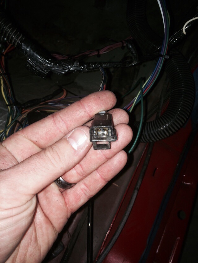

Guys I'm stumped.. Looking for the cruise control connector and can't seem to find it and stumbled upon these connectors while doing my ls1 wiring... So hear it goes! Another "what is this connector" lol. Any ideas??

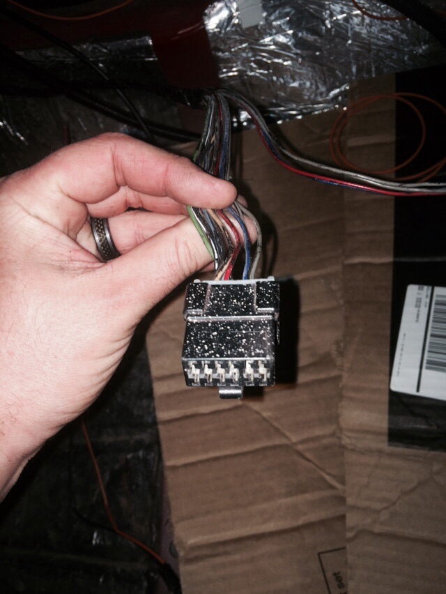

Another

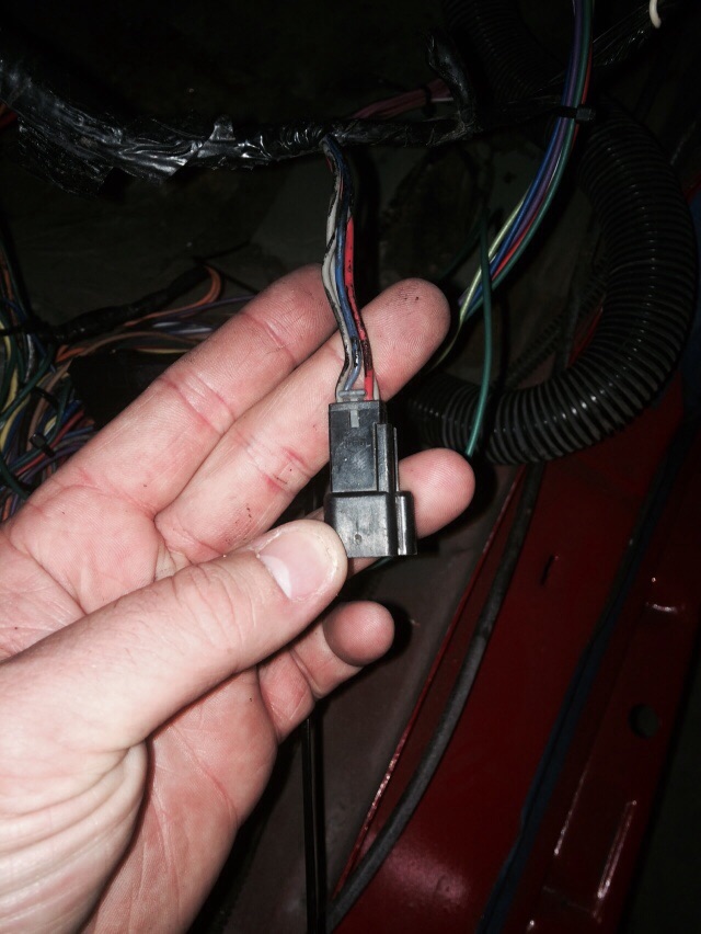

Different angle

Looking in my 91 Firebird service manual, the only connector face that looks similar to the first pic is the cruise control module. It's hard to see colors in your pic, but from the wiring diagrams I see GRY, DK BLU, GRY/BLK, BLK, LT GRN, DK BLU/WHT, LT BLU/BLK, and TAN all coming from the module, so if that connector has those colors then it's more than likely the cruise control module connector.
EDIT: This is assuming that a 92 z28 is reasonably similar to a 91 Firebird that the colors match.

Can't really tell, by colors first looks like cruise.
http://www.austinthirdgen.org/mkport...se_control.jpg

Thanks , Its been a while since ive done my swap. Trying to hook up the cruise. What I thought was the cruise control wires under the driver side dash are not. apparently the four wires go from driver side to passenger side where there is the 4 terminal plug then back over to the driver side. I have no idea about the big plug. I guess more research is in order
