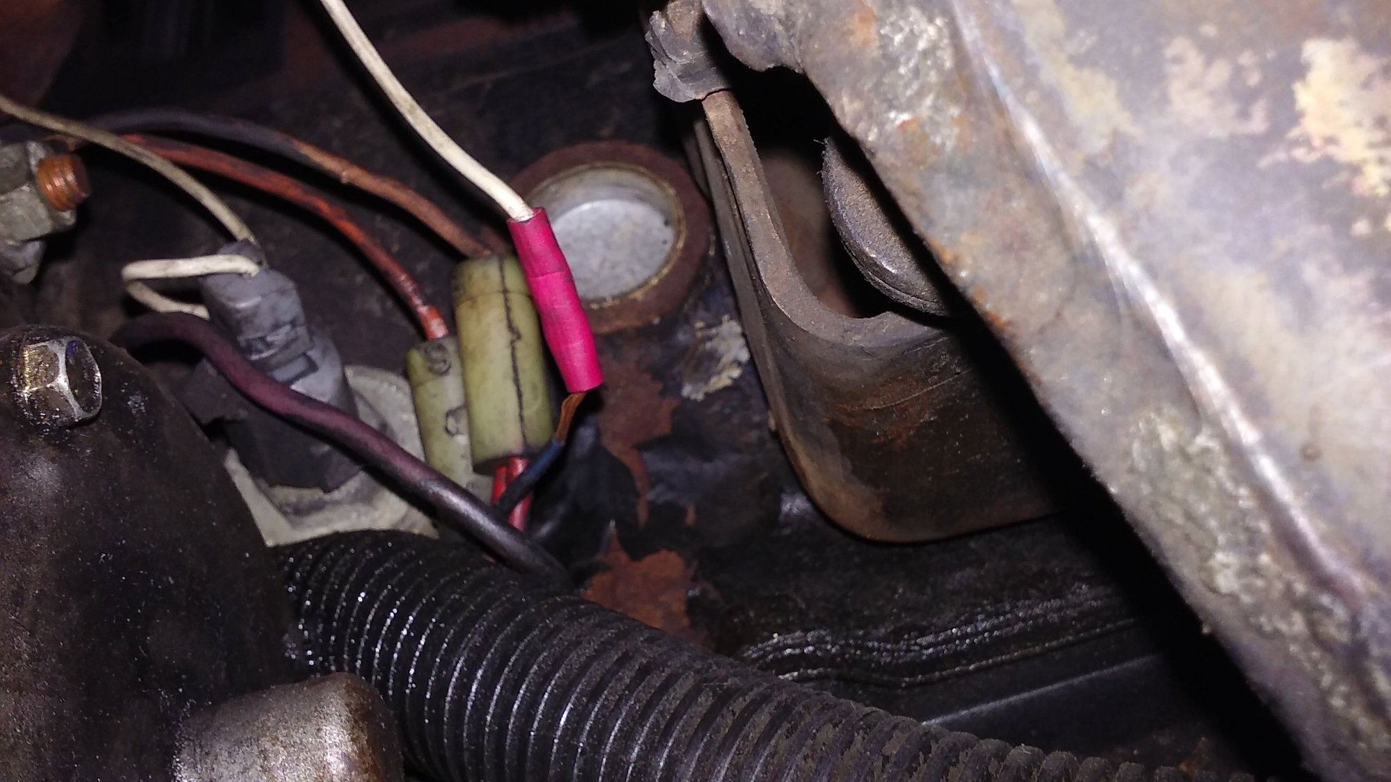

Well, that isn't right...
Noticed that into the starter instantly.
Any possible information of common grounds locations that I can check?
