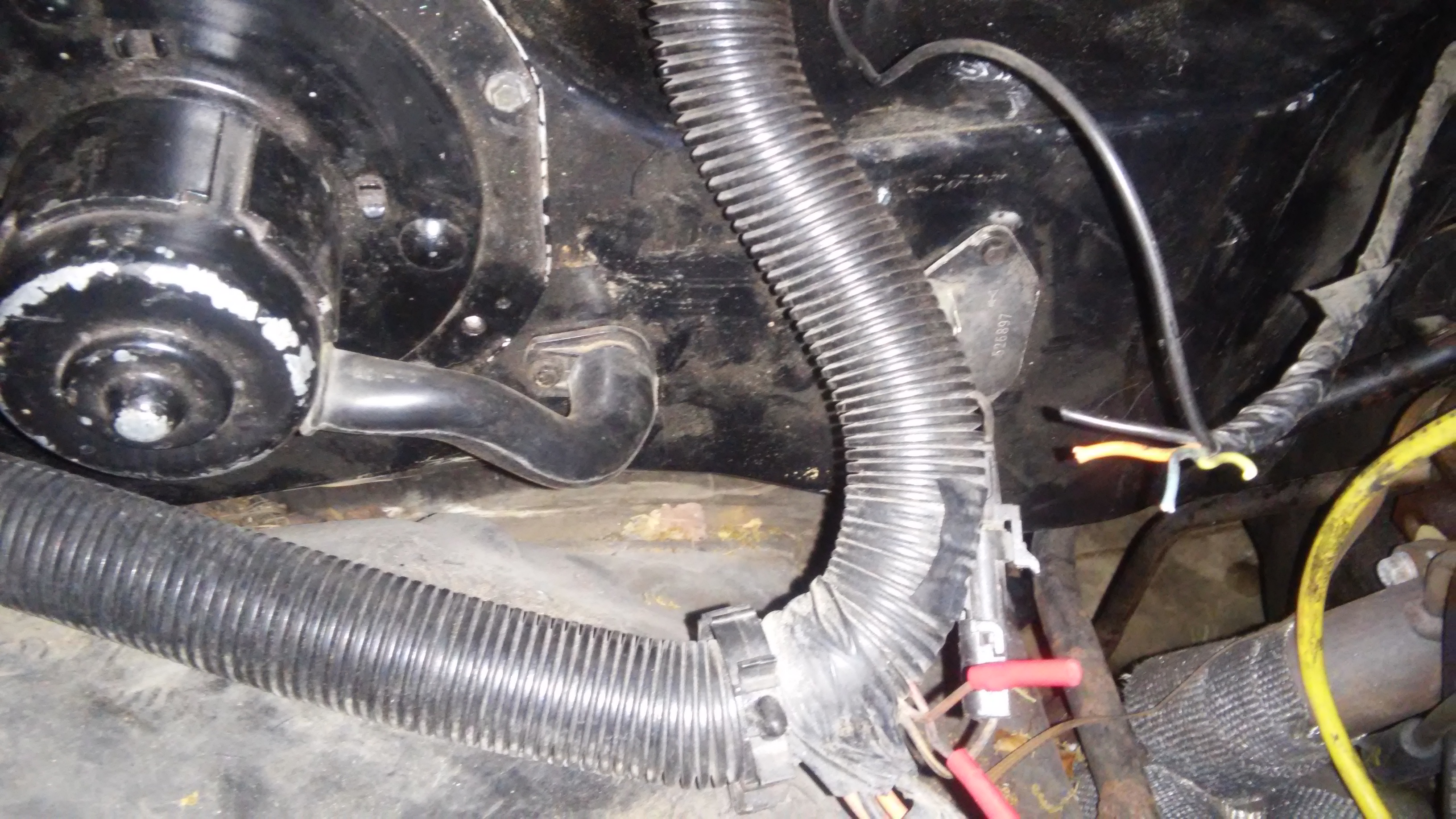

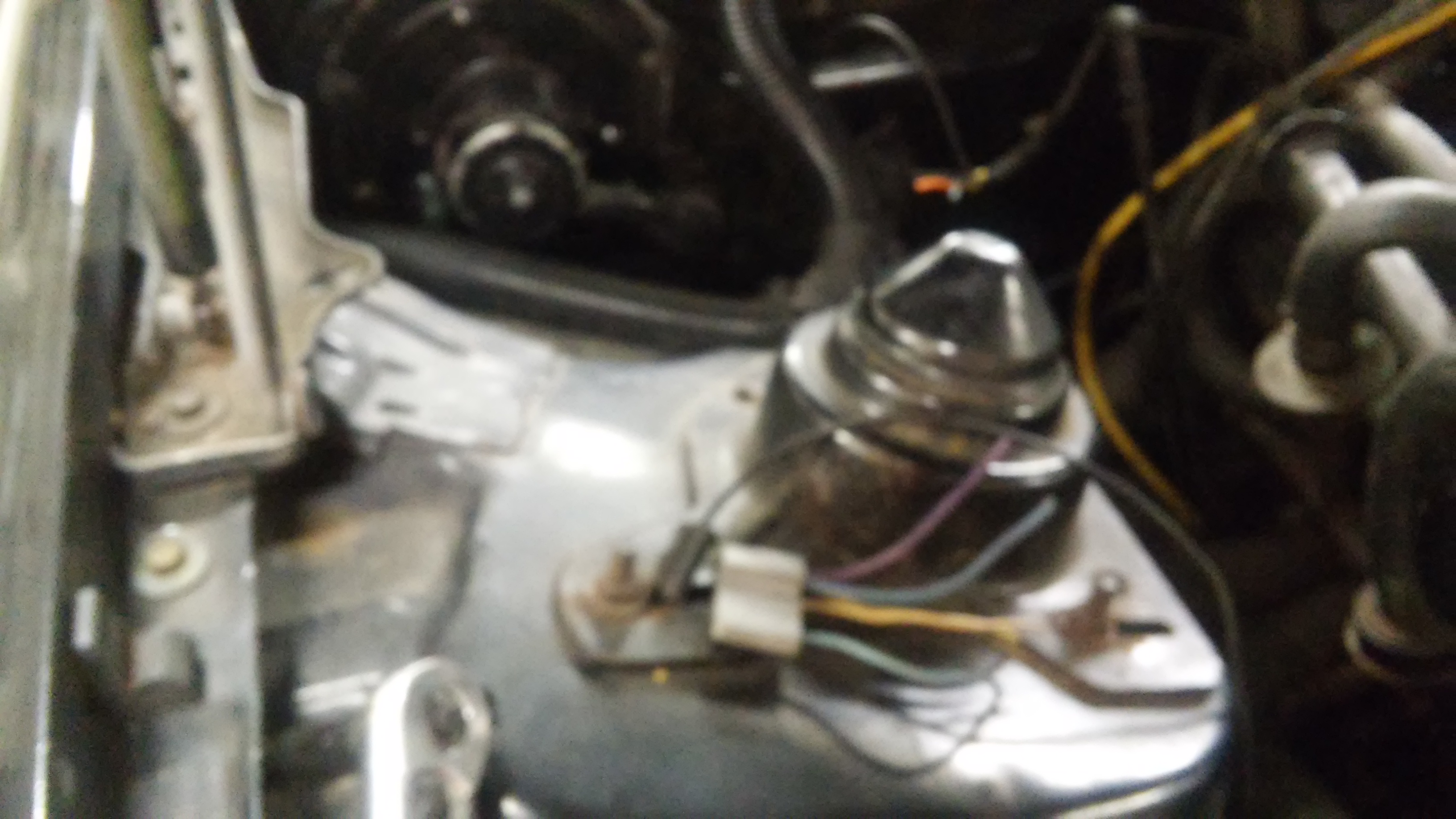

Don't know where the four wires coming out of the harness go and the plug was from an ac car and don't know what to do with the purple wires. They also spliced wies inside the car so can I used that plug to make it work with the non ac control and how to wire it up? Thanks for any help. I have pictures to see what I'm talking about.

The wires from the harness go to the gray plug.Looks like you have 2 yllw, 2 bl wires though.Its ppl,bl, yllw & tan on mine w/AC.The gray plug goes to that coil set on the blower case.The purple wire is for the blower motor, which splices off to that same gray plug & the hi-speed relay.
The sq plug inside the car is for the fan speed switch & the flat one is for the selector switch.I know there is a schematic on the service manual, but I don't have it with me.
