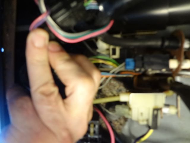

ok, i got under there and poked around but i don't know what is what. the manual says that the switch is on the brake mount and that i MUST drop the steering column but that doesn't look right. here's a pic of what i'm looking at.
THANKS!
