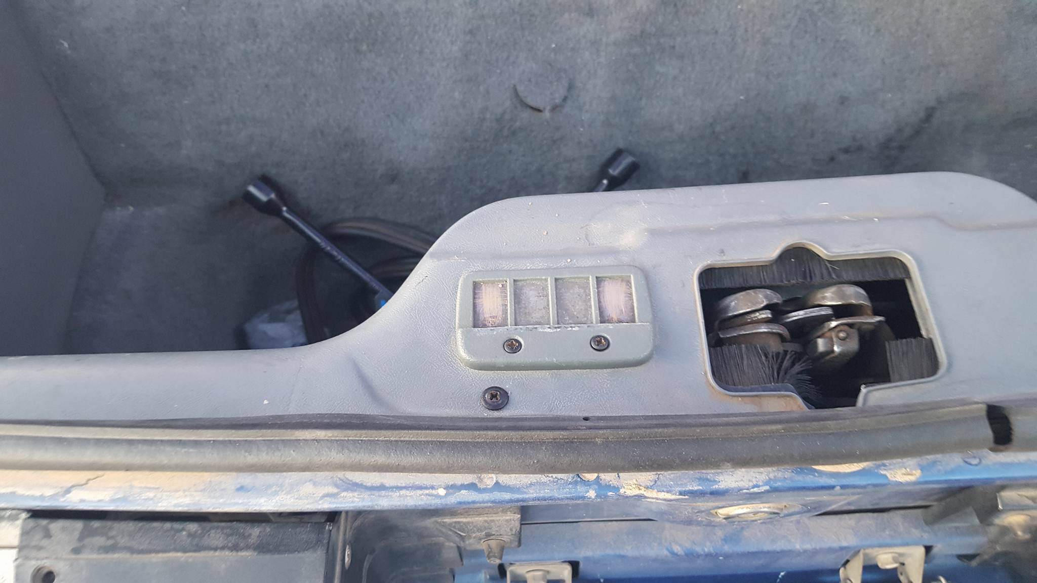

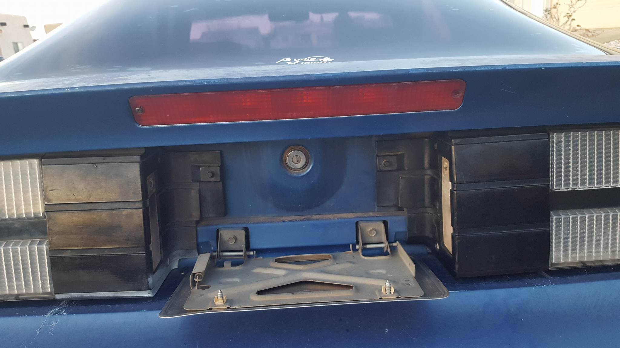

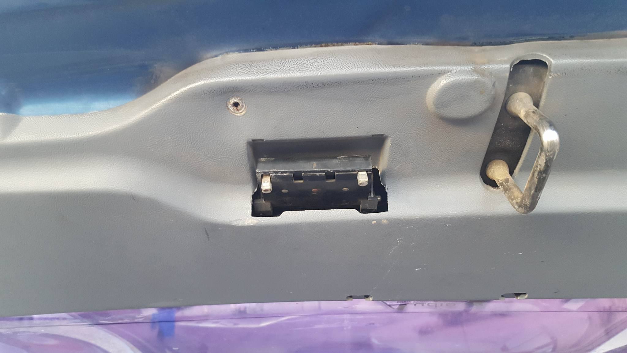

Hi All, so recently lost my third brake light... got new bulbs, all other lights work... what's the issue? I don't see any connection issues, everything's connected.
What do I do?
