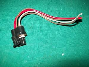

You can get a conversion adapter, or make your own.
You will need a pigtail that fits the new alternator.
See attached.
http://www.wiringdepot.com/store/c/1...s-Sockets.aspx
http://www.hotrod.com/articles/alter...kyard-builder/
Attached Thumbnails 2 wire alternator to 3 wire alternator-conversion.jpg   2 wire alternator to 3 wire alternator-pigtail.jpg

Haha thank you so much i actually just found this adapter like an hour ago. This will make it much easier. Do you know if i buy this adapter what do I do with the wire from the original harness. One wire runs from firewall to connector then the other wire goes from the connector to an eyelet that mounts to the bolt on the back of the alternator. Do i still need to bolt it to that location. Or just leave it disconnected

View the photos in the HotRod article. They show everything.

Anyone have the schematic for going SI to CS? That diagram is confusing and the HR article just says to buy an adapter or make your own... with no mention of HOW.
I have the 3 pin alt I'm trying to install in my 83 with the 2 pin plug.
I did see they make adapters, but don't see the point in buying one when all I need to do is cut my 2 pin plug off & wire it on to the new alt pigtail.
When looking at the adapters I also see they offer with and without warning light. Does that mean if you DON'T have a voltage gauge and just have an idiot light dash? I assume that'd make a difference in how it's wired up?
http://www.wiringdepot.com/store/p/5...ing-Light.aspx
Attached Thumbnails 2 wire alternator to 3 wire alternator-34507528_10212734273415621_6548699093349171200_o.jpg
