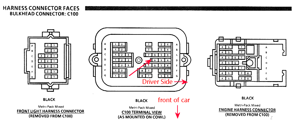

Welcome. On my 'bird, I can only guess is in the same spot for a Camarrow... , is literally next to the small bolt that holds the C100 plug to the socket. If you dig under the dash, it will be on the left (towards the hinge pillar, hood release, etc)
Attached Thumbnails Where does the white/tach signal wire come from?-c100_tach_passthru.gif

Sofa, I used to have the stock ECM with MSD, and all was well. At least, close enough to not notice. When I installed the Holley EFI, ignition is the same except of course the Holley now connects to the ICM, it now reads almost 7000 while the Holley data is showing at 4500. ...and trust me, the 383 TPI isn't at 7000!! I've got the rev limiter set, and the Holley unit reports accurate on data logs, but it just irks me seeing it rev to 7000 LOL!!!!!
I've read about that MSD adapter, and I'm considering that too. Some seem to need it, some don't. Not really sure why. It could just be a bad tach, but I want to try and see if it's something else first. Relatively inexpensive items, and others have had success, so we'll see. The speedo is all freshened up and reads dead on, and all the other vitals are handled through the Holley LCD screen, no reason I can't leave the stock gauge set up, but the tach just drives me nuts!
Deadbird, I'll look, see what I can find.

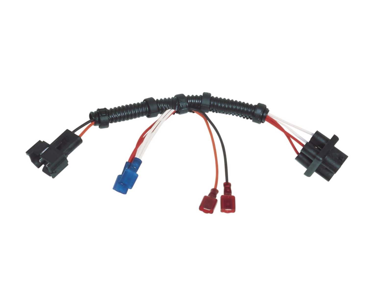

See if these help you.
https://forums.msdperformance.com/sh...-to-Holley-EFI
https://www.mpsracing.com/instructio...ringManual.pdf
Attached Thumbnails Where does the white/tach signal wire come from?-msd-6-series-gm   Where does the white/tach signal wire come from?-msd-6-series-gm

So that's actually the MSD harness I'm using already. I've isolated the factory tach wiring, and it's either running of the MSD box "white" wire, or the box's dedicated "tach output" port. I've run it both ways, and both ways read high. This would make sense as they're both coming out of the MSD box.
HOWEVER....as you can see by that schematic, my coil now only has the black connector. It does NOT have the grey connector as that connector plugs into the MSD harness. I attached a pic from the googles, and this is how mine is now. Just the black connector from the MSD harness. That circled port is where the WHITE wire from the GREY connector came out and went directly to the tach. .....sooooo it would stand to reason that I can still connect it directly to the tach, and bypass the MSD. ....stands to reason this would work. Still....maybe the signal is still not gonna work since it's all still wired into the MSD box. ....still may have to pick up that filter.
...and even if this doesn't work, I can still bypass the MSD all together for testing purposes and confirm whether it IS or is NOT the MSD box.

The coil, if you're using the MSD harness, is now triggering the coil. The white terminals and pink terminals share a common buss *inside* the coil.
If you key ignition on and were to meter the pink coil terminal that doesn't have a plug... you would get +12v
The tach ouput of the MSD is a filtered signal, less the MSD.
