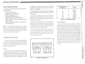

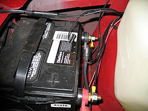

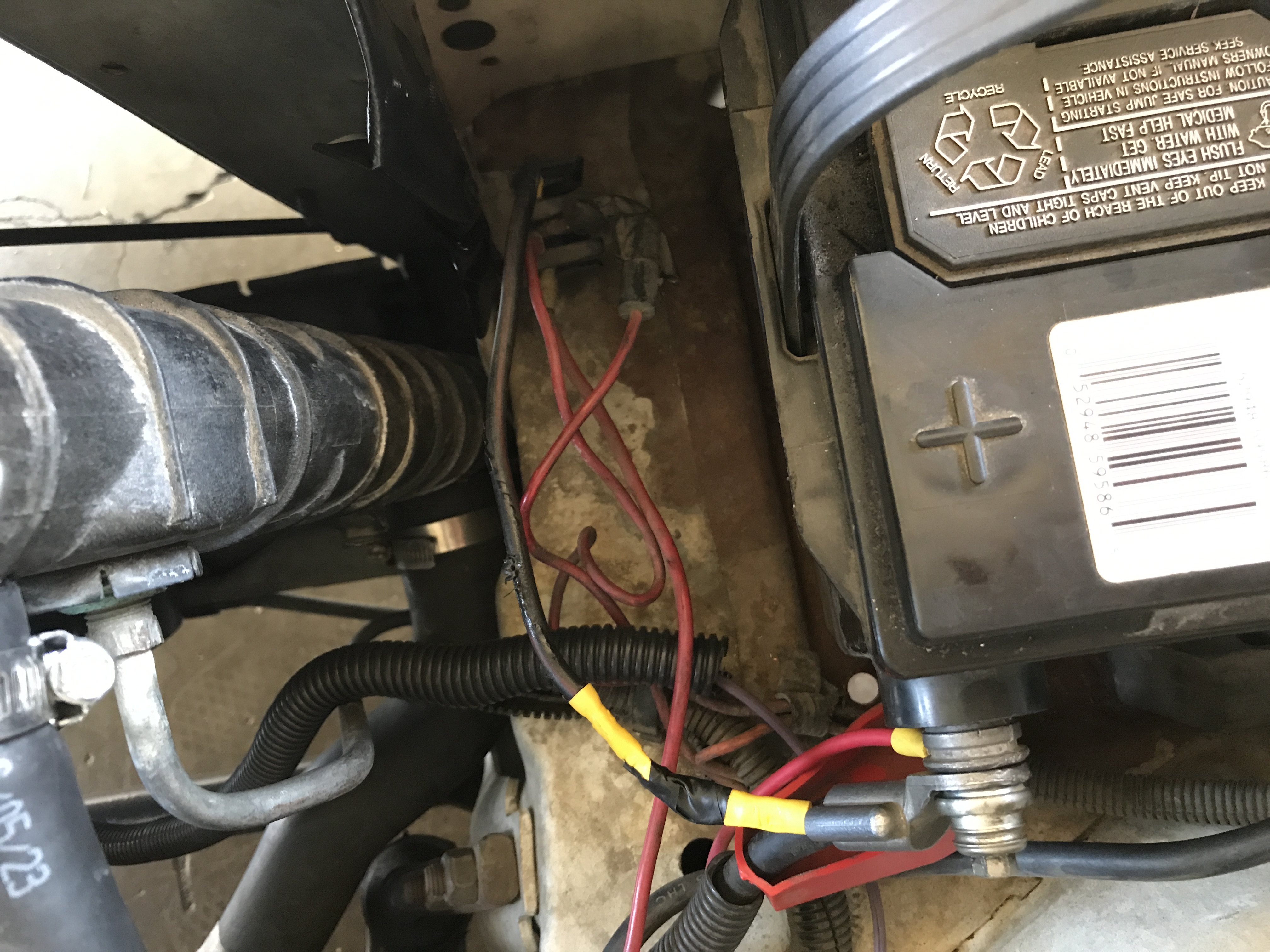

Hey all so today after replacing the rear lcas and phb i go to start my car and notice the idle is all lumpy jumping off the stall saver. I visually scan my gauges and instantly notice the battery gauge shows well below 12V (usually shows 13.8-14.v). I go check the battery and notice this.
Half the wire was just touching itself and readily able to break off. As soon as i moved the wires together the car jumped back to normal. gauge showed 14volts
Now 3 years ago i had to replace the stock positive battery cable (https://www.thirdgen.org/forums/tech...-loss-car.html ). I bought a cheap one from autozone and it worked fine until now. It came with a small wire that came off (show in pic melted) and went to that hot wire, that i had to splice together, which to my understanding (which could be completely wrong) looks to power that hot 'junction'. Only the autozone cable small wire was much smaller in gauge than the original wiring, which caused the melting.
What im wondering is can i just throw a connector on the 'hot' wire that goes to the junction and hook it directly to the positive battery post (like my red wire shown in the pic that powers a circuit breaker/relay for aftermarket fan)?
Or should i resplice into that small wire that comes off the positive battery cable and hold my fingers until i can get a new quality cable. I just know if i resplice into that smaller wire its just going to melt it off sooner or later...
are you guys still using Innovative Wiring? http://innovativewiring.com/
Thanks all for information and advice!

How far back into the loom did it burn?
Old Sep 8, 2017 | 10:38 PM
Ghettobird52's Avatar
Joined: Apr 2010
Posts: 1,028
Likes: 11
From: Modesto, California
Car: 88 Firebird Formula
Engine: LO5 5.7 TBI/Ebl Flash
Axle/Gears: 2.73 stock rear end
Re: Can i hook this wire straight to the battery instead? (Pics inside
on the side thats connected to the 'hot junction'? No where. I personally put that plastic loom on. It only burned where i tried to show in the pics. Only right at that splice, and then all that on the other side which is the smaller gauge wire that came with the autozone positive cable.
It looks like its connected directly to the battery through the eyelet, so I can't imagine it wouldn't work for you. But I would trace it back as far as you can. The wire may be exposed farther down and grounding out. It burned for a reason.
Old Sep 8, 2017 | 11:09 PM
Joined: Apr 2010
Posts: 1,028
Likes: 11
Yeah thats my thinking too; the small connection was there for this 'hot junction' but i could just throw a connector on it and grab the post?
I'll pull the plastic loom all the way off tomorrow to verify but it looks just like its right at the splice and afterward, only on the small gauge wire. My believing is thats why it burned, is because its too small of a gauge for that much.
Keep in mind this is melting over 3 years.

Id cut that black wire up to about 1/2 to 1/4 from the batt connector, then solder (not crimp) your new wire to that 1/4 end, heat shrink afterwards.
Old Sep 9, 2017 | 12:36 PM
Robbie_S's Avatar
Joined: Sep 2016
Posts: 124
From: Ventura County, CA
Car: 1989 Iroc Z
Engine: 5.7
Axle/Gears: Currie 9"/US Gear Lightning 3.00
God speed
Old Sep 9, 2017 | 12:40 PM
Joined: Apr 2010
Posts: 1,028
Likes: 11
that wire is 14 gauge, while the wire connecting the hot junction is 10gauge... I've also tried and tried to teach myself how to solder... i just cant get the rosin to melt correctly. ive tried over and over at a bench for a couple hours, with different wires and different setups. but just cant seem to learn it correctly.
I ended up capping that wire off the autozone positive cable and running my own 8 gauage wire directly from the hot post, to the junction. Works fine 'so far'

No. No. No. No. No. No. NO. NO. NO. NO! NO! NO! NO! NO! NO!!
NO!! NO!! NO!! NO!! NO!! NO!! NO!!
NO!!

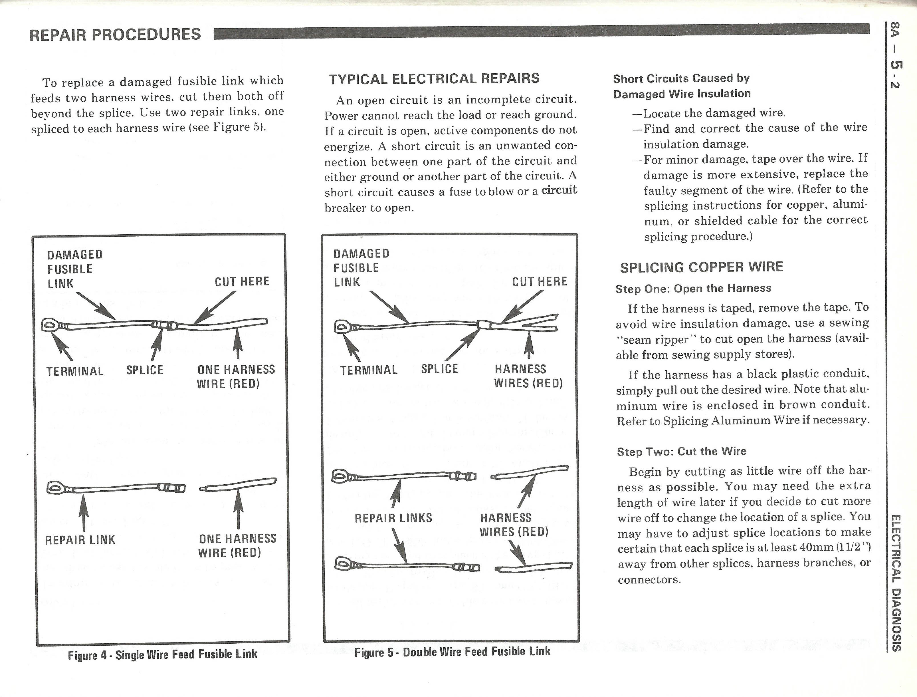

Never ever ever ever replace a wire that has burned twice with a heavier wire. All you're doing is removing the "fuse" that is currently limiting the circuit and keeping it from burning your car down.
Think about it. Currently (pun not intended) when whatever is shorting, or drawing too much current, over loads the wiring, it's melting at the battery. Now if you give it a wiring upgrade to feed it's appetite, what's going to happen if it's an electrical failure or short elsewhere in the car? It's going to burn there instead. "There" might be behind the dash, or under the car where you won't see it until you're the proud new owner of the burned out shell on the side of the highway.
Step 1) Identify exactly what that wire is feeding. This can be complicated, because TBI, V6, carb, TPI cars all grab power for different circuits from different places like the positive post at the battery, junction blocks, or the positive post at the starter solenoid. Your best bet is to pick up the GM/Helm Service Manual or Electrical Diagnosis Manual if there's one for your year/make/model car. Then study the wiring diagrams until you can figure out what the wire is feeding.
Step 2) Read the manual. It will tell you exactly HOW that circuit is supposed to be fused. Usually, it's going to be a FUSIBLE LINK. There's actually a section in the manual that discusses fusible links and how to properly replace them.
Step 3) Install a new fusible link into the circuit. If it burns again, figure out what's wrong with the circuit using the manual and fix the problem, not the symptom.
Step 4) Enjoy driving your car instead of coming on the forum and telling us how your car burned to the ground.

can i just state this; nothing burnt twice? this wire was replaced 3 years ago and had a smaller connection heading to the hot junction rather than the larger wire the original cable had? my thinking is that nothing else is overloading, shorting. Its this 14gauge tiny wire that is overloading off the battery and attempting to power the whole hot junction rather than the 10gauge original wire that the stock cable had?
To state again, the original part of this wire was not burnt at all...? Only the small tiny 14 gauage wire that came off the autozone positive cable.... So nothing else was burnt...
So pull off that wire i just installed, and install a fusible link, also smaller wire, connecting the hot positive cable to the hot junction?

Ty for the tips on soldering... going to really attempt to learn it. I know i need to figure it out as crimping should really just be temp...
Well forshure the NO NO NO NO NO NO NO scared the living hell out of me to pull that wire off my battery and reconnect through the wire off the positive cable it was originally hooked to. I attached some pics just to show you the original wire size... It looks like it was original 8 gauge... I think thats why this small wire burned... Heres how its hooked now... I know like s h i t
Attached Thumbnails Can i hook this wire straight to the battery instead? (Pics inside-img_1333.jpg   Can i hook this wire straight to the battery instead? (Pics inside-img_1334.jpg   Can i hook this wire straight to the battery instead? (Pics inside-img_1336.jpg

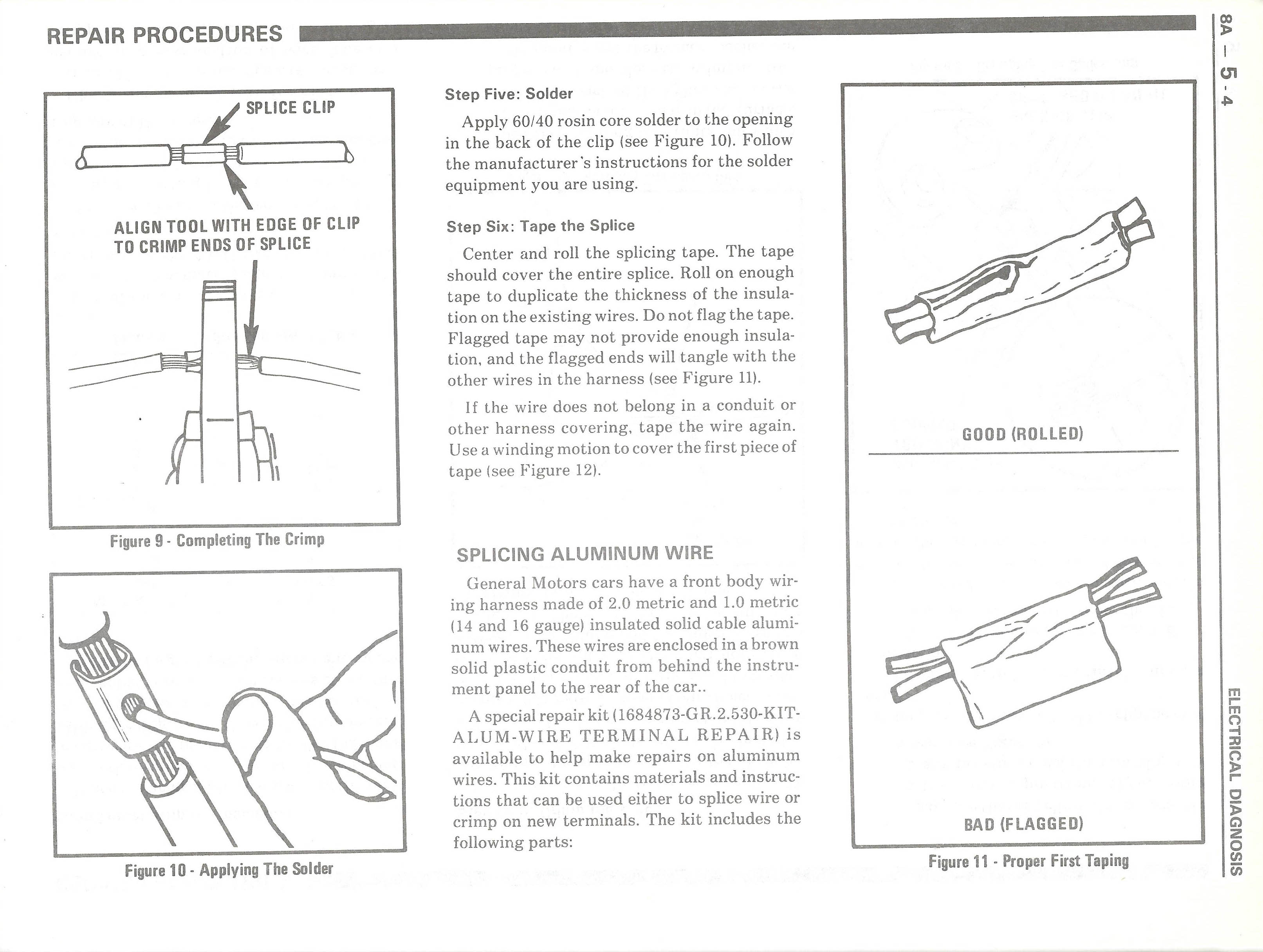

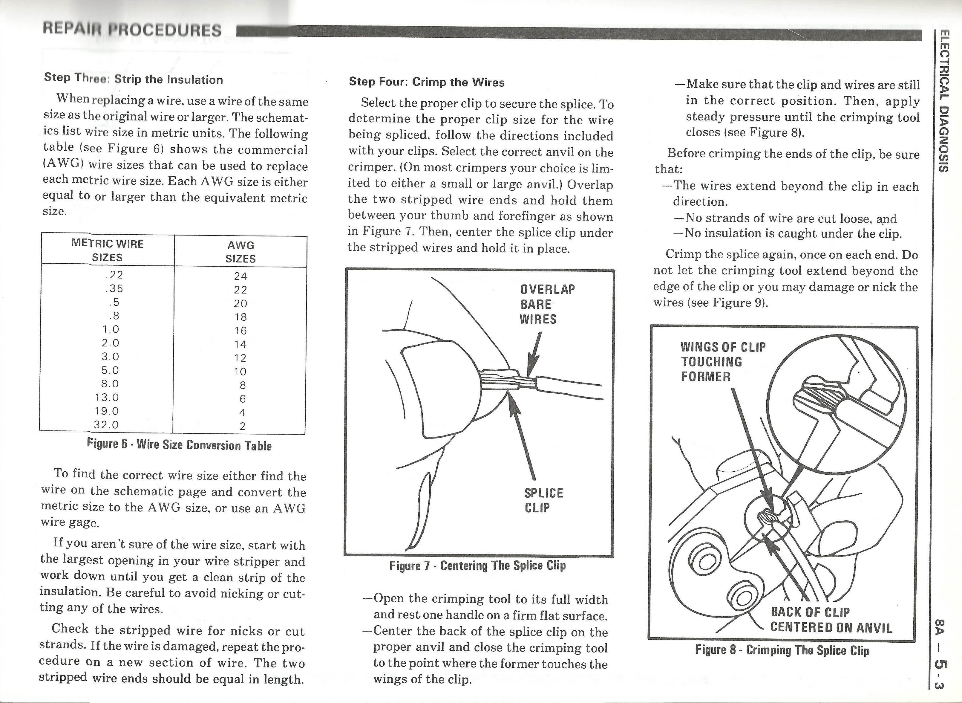

I scanned a few pages from the 1987 Camaro Elictrical Service Manual supplement. While the wiring diagrams aren't exactly specific, the repair procedures are and the diagrams illustrate what I'm trying to explain...
These two diagrams show the power distribution for an 87 Camaro with TPI and the V6. They illustrate how different cars pick up power sources at different places. Notice how nearly everything is fused by a fusible link? The TPI diagram shows the battery cable to the starter solenoid where several fusible links take power to the car, and another wire to the alternator along the way supplying power to another fusible link and an inline fuse. Now notice how the positive wires from the battery are marked "19 BLK" and "5 BLK/RED" and the single number 2 labeled underneath? 19 & 5 are the wire sizes. They're metric, and there's a chart to convert them to AWG in the manual that I'll link in a minute. The "BLK" and "BLK/RED" are the wire colors, the single number 2 underneath is the circuit number, not terribly important but not to be confused with the wire gauge.
The V6 diagram shows how on the 6cyl (like TBI cars) GM used an additional junction block instead of having all the wiring pick up at the positive post of the starter solenoid. Notice here the battery cables are marked 8 and 19, which translate to 8 and 4 AWG wire.
Note also how both diagrams have the fusible link colors and size called out, "RUST" "RED" etc. When repairing these connections, the new wire and any fusible links need to match the original wiring. You'll want to refer to a diagram for your exact year/make/and drivetrain so you can do the repair by the book.
Below I'm going to link the pages of the service manual that cover electrical repairs, fusible links, and splicing wires. Pay special attention to the wire conversion chart, and fusible link color/current rating chart, but the entire section is worth reading.

Im going to get my car on ramps right now and chase the 3 wires that come off the junction block to verify. I can instantly see that one is right there off the connection (you can see in pic) and it shows that on the 88 diagram for VIN E as well.

Right; i totally understand what you mean about overdrawing on the junction block, or another problem. But there is no other melting or electrical problem (that i know of) except that wire. And just to my (very small) knowledge it would think that a 10gauge wire spliced into a 14gauge would have problems... (Ie melting).
Awesome ok so how i had it wired on post #15 would work? I think im just going to play it safe and grab some 10awg wire and use that instead of 8gauge. My car had this black/red 10awg wire on it from stock so thats the size i'll use. That stock wire didnt burn so 10awg should be ok. and i'll use this as a TEMP fix.
