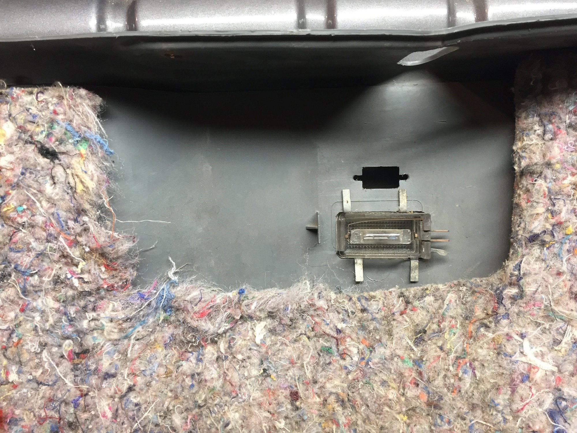

Here's a shot of the metal removed:

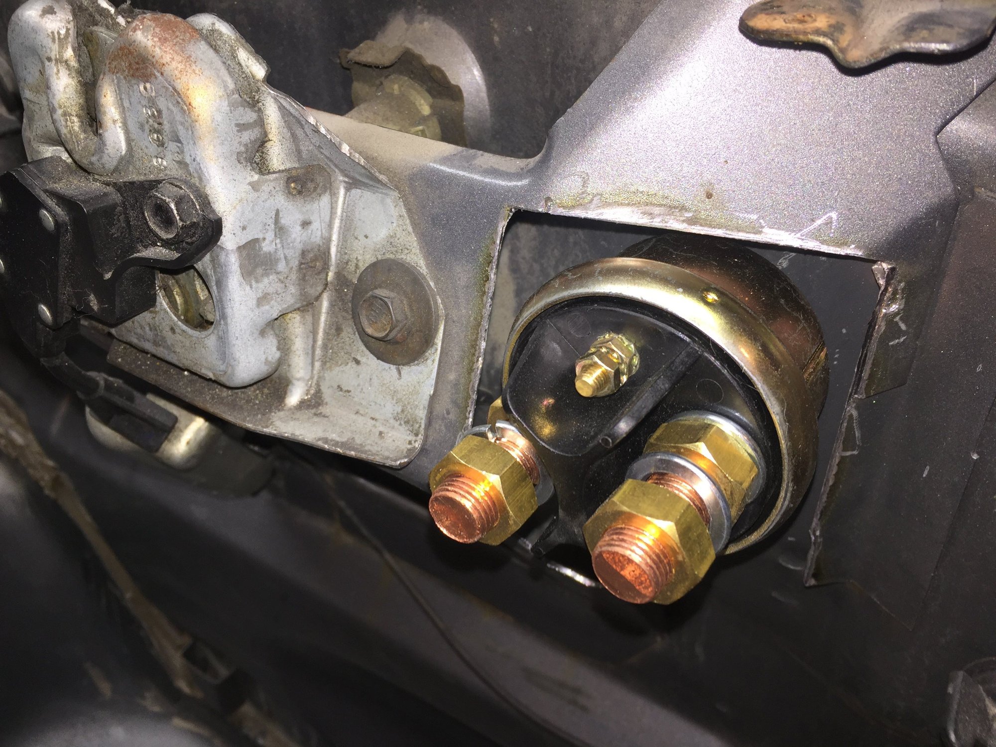

With the switch installed from the inside:
The posts do stick out past the hatch release, but still fit behind the plastic trim. I removed a bit of the insulation/backing on the panel to allow a bit more room. I'll be putting proper insulated boots on the terminals before reinstalling the panel:

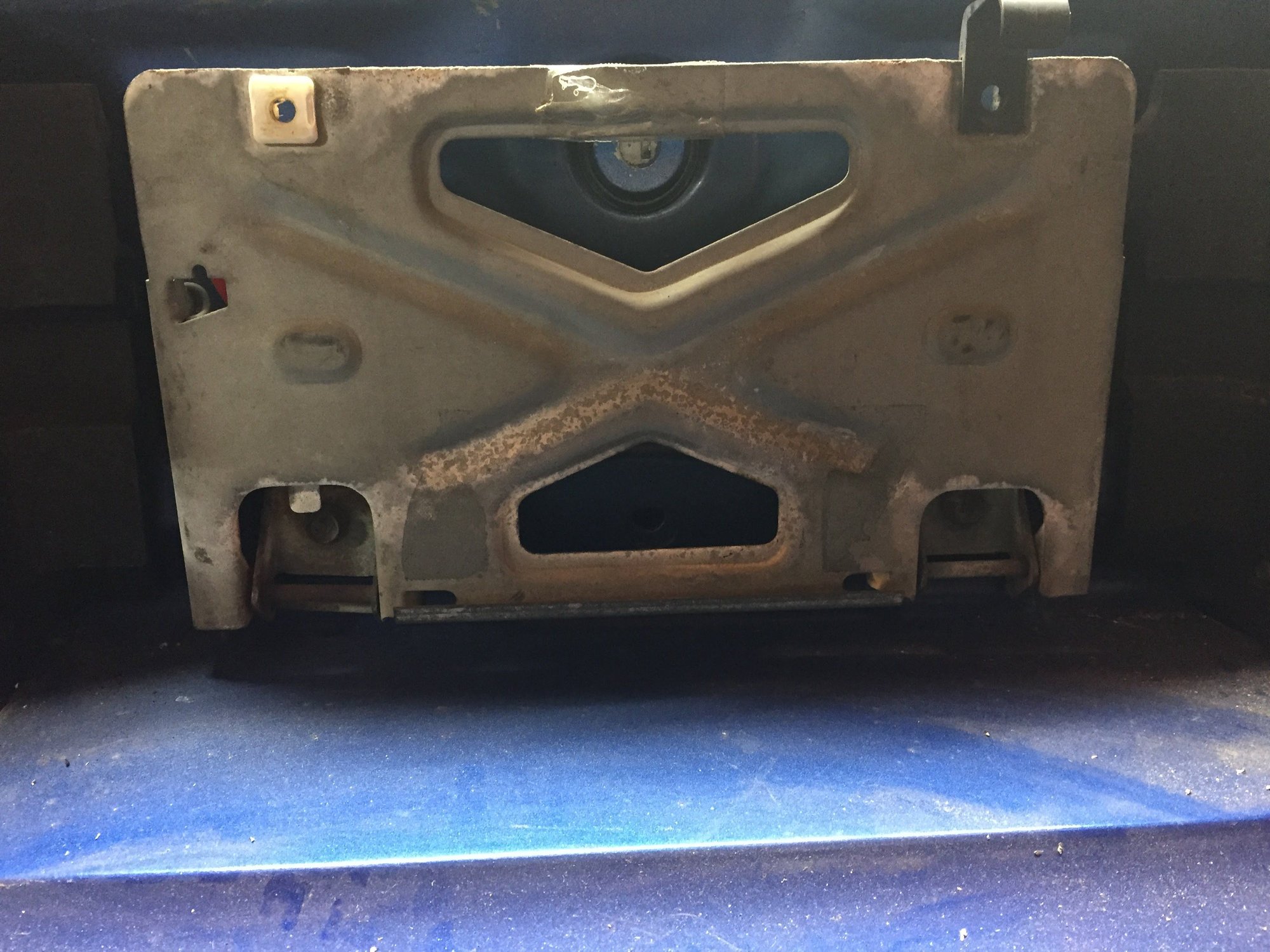

Picture with license plate closed. Switch is completely hidden. Just need to install a longer rubber bump-stop so that the plate holder doesn't rest on the switch.

I'd see about welding or at least riveting some metal back in on the bottom.
Old Apr 9, 2018 | 01:37 PM
AustinW13's Avatar
Joined: Jan 2018
Posts: 3
Re: Battery relocation with cutoff switch behind license plate
Yes, now that I've got it fit in, I'll be welding a support back in at the bottom of my cut out! Thanks.
