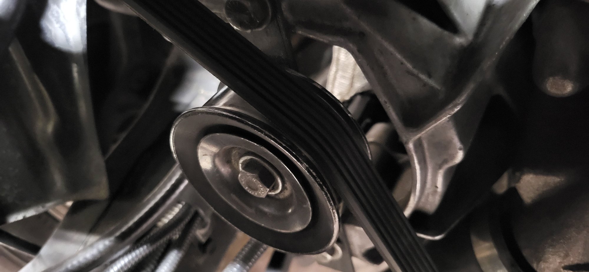

Re: AD244 conversion - took the plunge
I got a Dayco 5060990.
The only thing is I'm not running a smog pump... I put an idler pulley in its place, basically a thick metal strip bolted from top to bottom with the pulley from a tensioner mounted in the middle of it. So that may affect things. The pulley is smaller, so it probably an actual smog pump pulley will need a bit longer belt.
