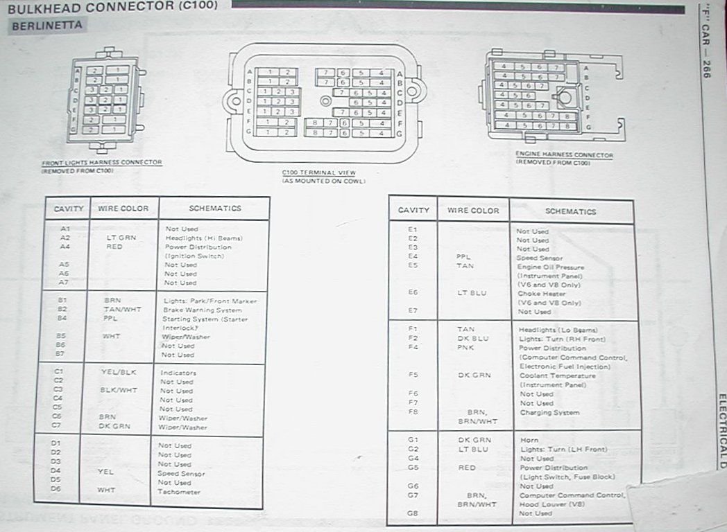

We are doing a father/son project my son bought two Camaros a 84 which is being restored and a 92 donor car (wants the ground effect and misc). My question is what wires do i have to keep coming thru firewall into dash we are going back to old school and getting rid of all ecm, wiring and polution control going with hei distributor non computer carb. etc want to get rid of the rest. Can somebody help with what i have to keep and what to get rid of?

Maybe John in ti will chime in. Here is a link to 92 c100.
the main power to the car from the starter , coolant gauge and charging system, ign power all go through c100. The efi or computer controlled carb can be removed they all run through the passengers side kick panel.
http://www.austinthirdgen.org/?pid=19

Here is 84 c100 diagram
