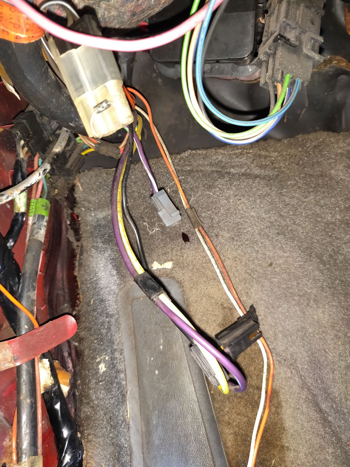

Hi my name is Nick and I am new to this forum. I recently bought a 1985 Trans Am from Craigslist and trying to bring it back to life. I managed to get the engine started,changed oil,spark plugs and all fluids look ok. I did download the wiring diagram but it is not so user friendly!

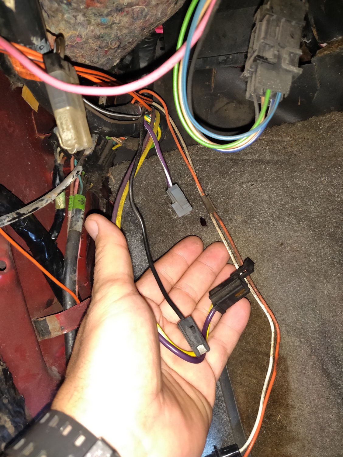

I found a few wires under the dash (drivers side) which were just hanging there. One plug is Purple and Yellow, one black and one Purple with white stripe. Any idea where these are suppose to go?

Yellow and Purple are for the T5 clutch pedal safety interlock ( not used if your car is an auto )
BLACK *appears* to be for the rear hatch Release Solenoid. ( some early cars have a connector,.... most cars have a long wire with no connector. )
PURPLE/WHITE looks like the rear hatch Defroster wire.

Thank you John for the quick reply. I think I don't have any of those options of my car so will zip tie them to the harness.
