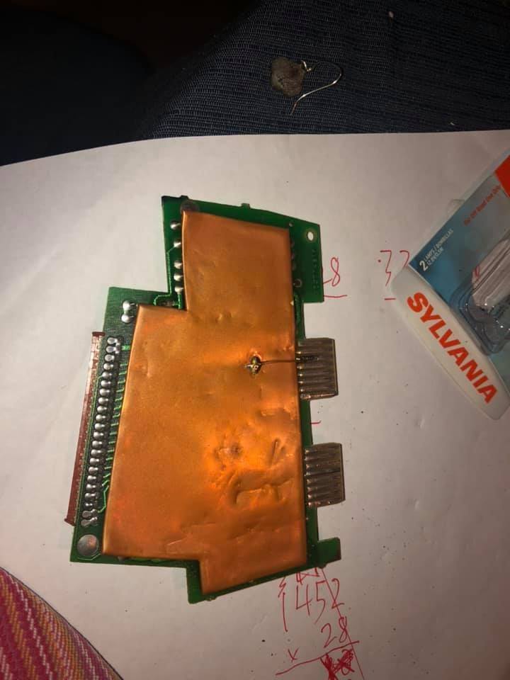

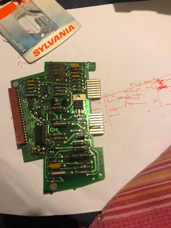

I already have the whole thing apart. I couldnt see any burnt traces. And I wish I had a spare dash. Those things are hard to come across. If I knew which pin on the board was power I would throw 12 volts at it and see if the display worked. I was wondering if the display itself may be delaminating. I have managed to find 2 pins on it that ohm out to all of the display pins but that is pretty much at the outside of my electrical skill at the moment.
