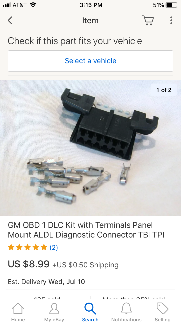

Hello all, was hoping to see if anyone knows the part number for the obd1 aldl connector and terminals.

The terminals should be unsealed metri pack terminals. Measure the terminal width to get the series.
The connector should be easy to find if it's available. Go to the Aptiv e-catalog, and search for a 12 pin female connector and start clicking links.
Or, look for a PDF of the Aptiv, Delphi, Packard Electrical Division, catalog, and flip through it until you get to the connectors.
Can't say I ever looked for the female half. I know the male half isn't listed anywhere that I ever saw.
