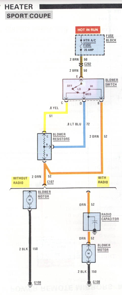

Okay...well my heater is not workin at all. It did work at one time...but the idiot who owned my car b4 me did an engine swap and screwed up some of the wiring. I know the blower motor works...its just that I am not getting any juice to the switch in the actual heater control unit. Somebody told me to run 2 wires 1 from my neg on my battery and 1 from the pos....and then splice the pos and neg wires on the heater swich control thingy in order for it to work. Now my problem is I dont know which color is the pos and which is the neg. I have an '83 TA as u can see from my nick name. Please help me ASAP...it is cold here in NY...and I need some heat. Thanks.

Here's a diagram of the blower system (without A/C - the "with A/C" diagram was too large to post).....The schematics may be found on line at: http://www.geocities.com/vtcamaro/Wire-Diagrams.html
