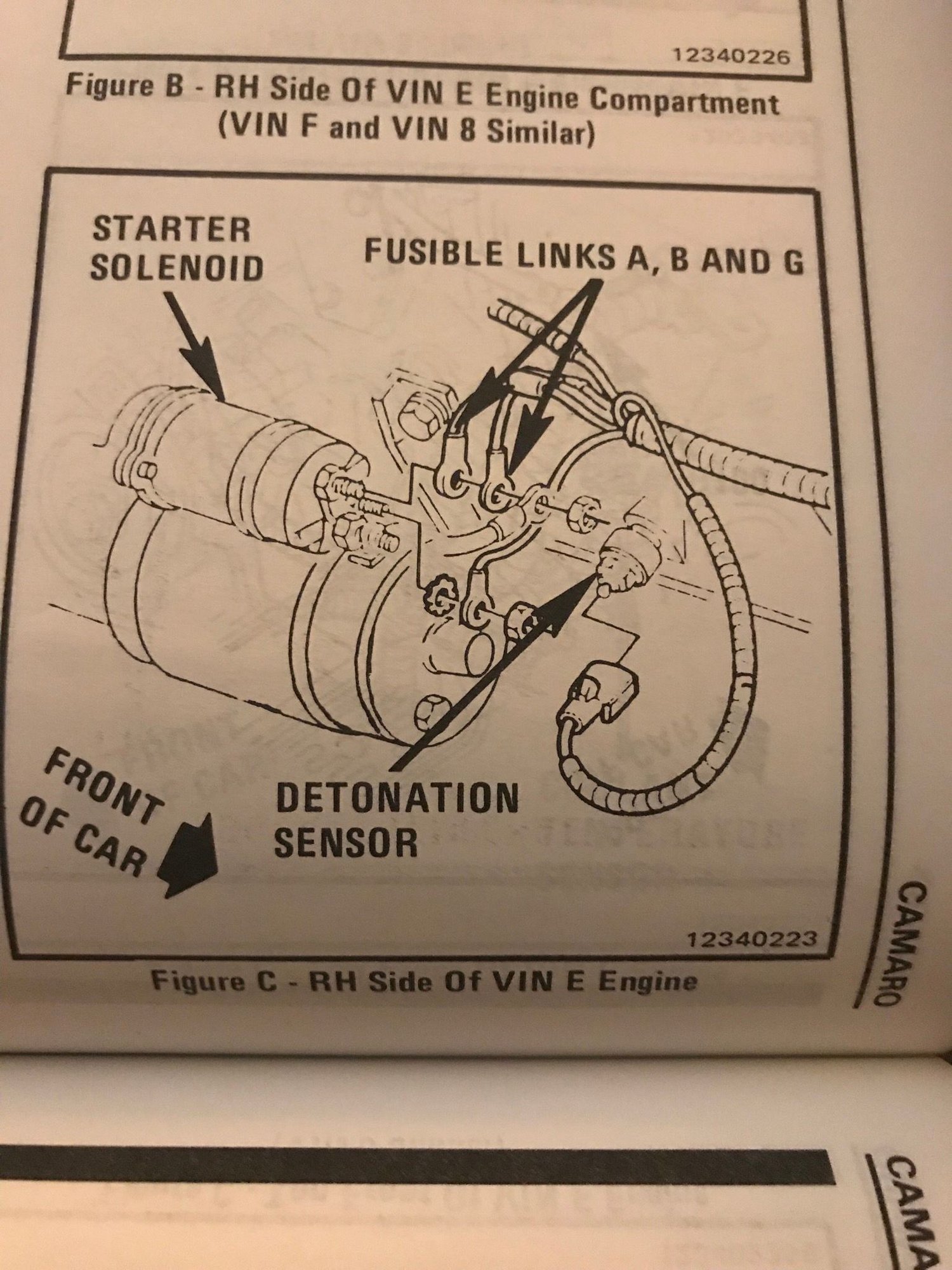

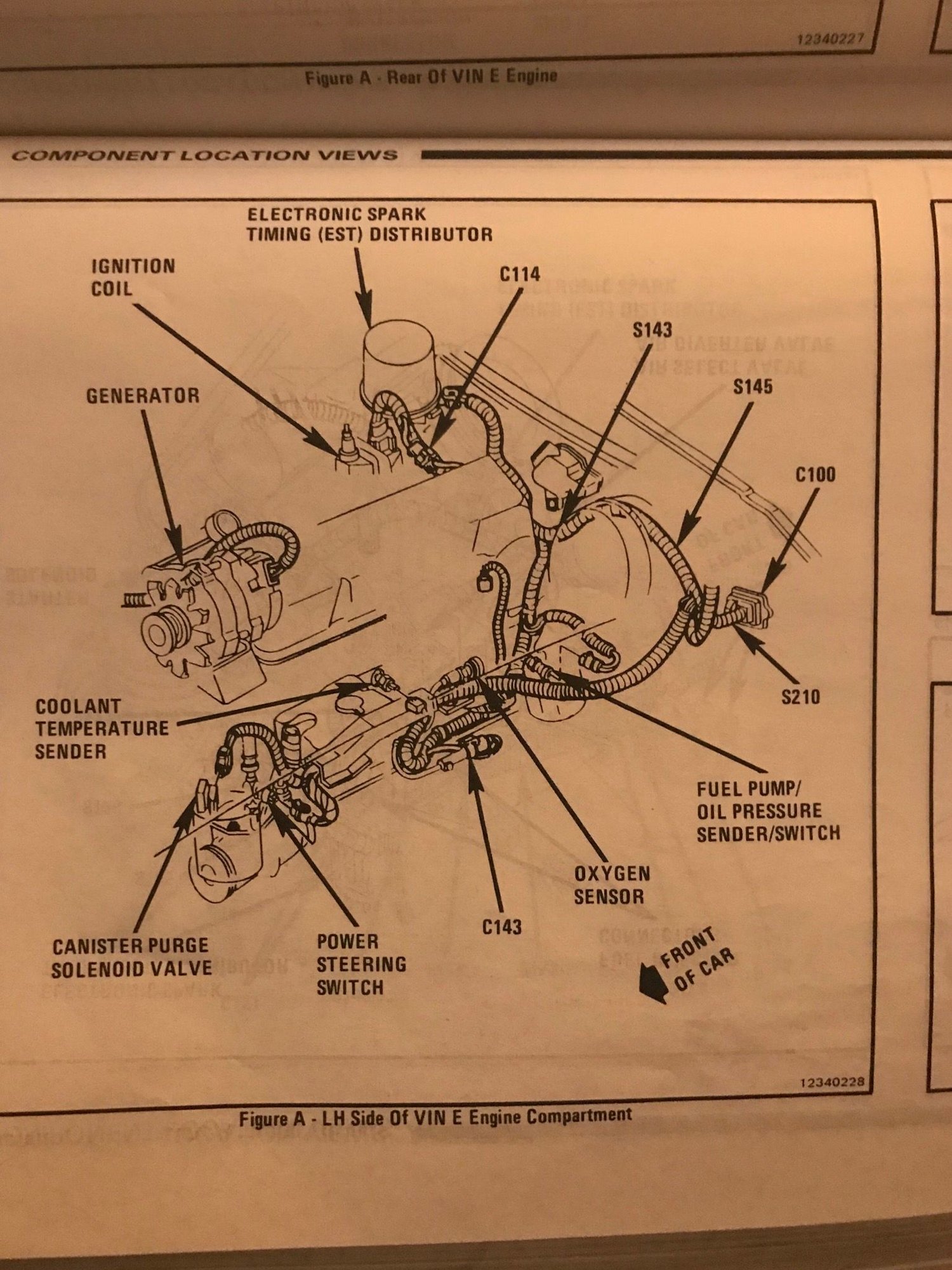

These pics are from a 1991 factory service manual. Camaro TBI 5.0 VIN E. Knock sensor is a dk blue wire.
It goes directly to the ESC module.
It breaks out of the starter wire harness
Wire routing
The coolant fan switch is a DK Green/white wire.

I'm going to guess that in Figure C of those FSM drawings, the wire going toward the upper left that just disappears below the word "fusible", is the fan switch one (grn w/ wht tracer), that you have currently hanging there without the connector body.
