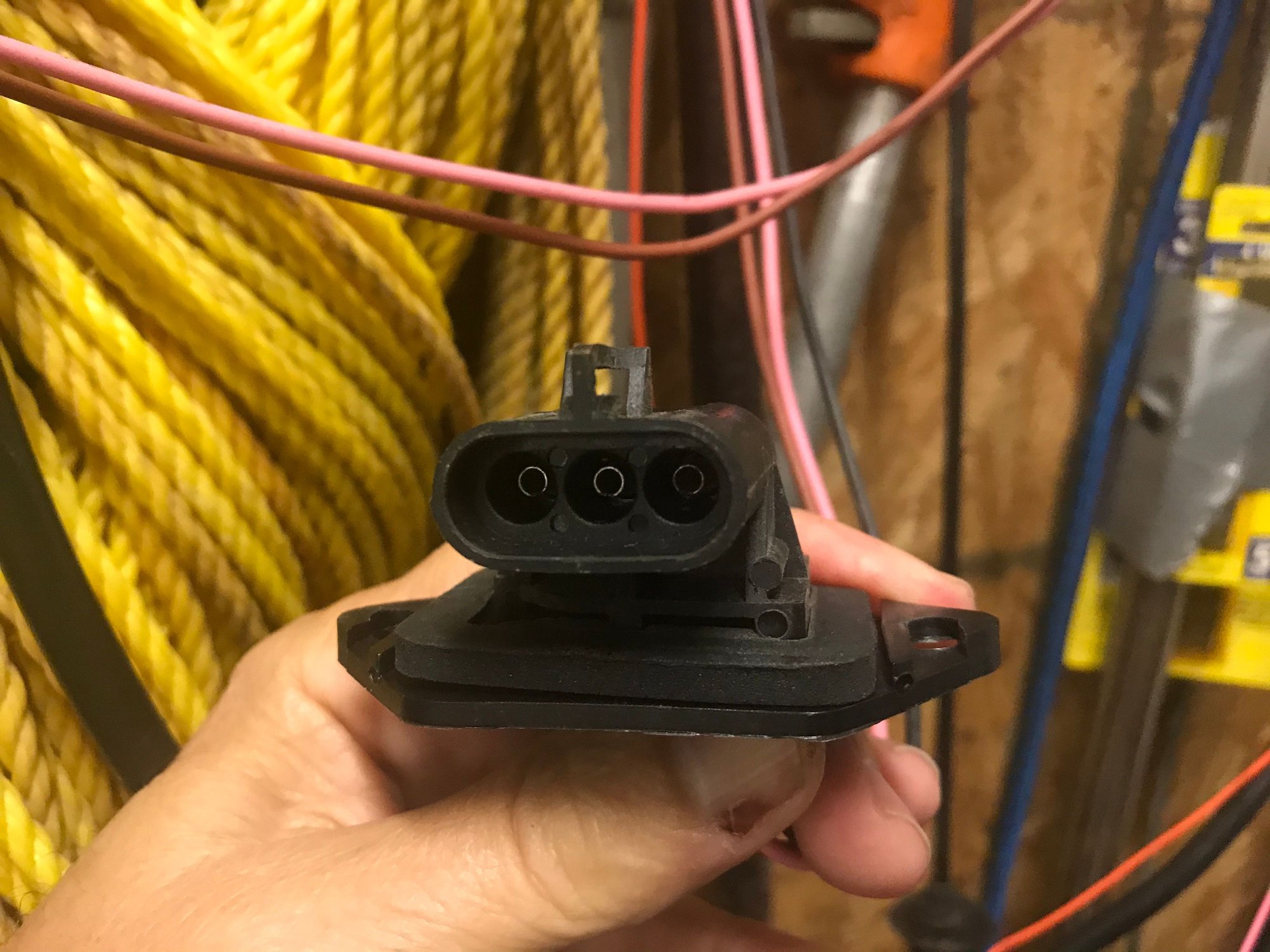

Does anyone know what size the 3-pin type connector is that goes into the bulkhead fitting for the fuel pump and level gauge? Or does anyone have a good one off a old harness. Want to use the OEM bulkhead connector for my build.

The OEM bulkhead has a groove guide on the center top and the lower left for the connector slots. The one I bought had two top grooves on the first and third pin opening. So it seems the one I need is special.
It's not a typical Weatherpack connector, you need one with the provision for the extra lock.
Try Delphi / Aptiv 12020829
https://www.mouser.com/ProductDetail...yku%2FVp55o%3D
Use the datasheet to find the matching terminals.
