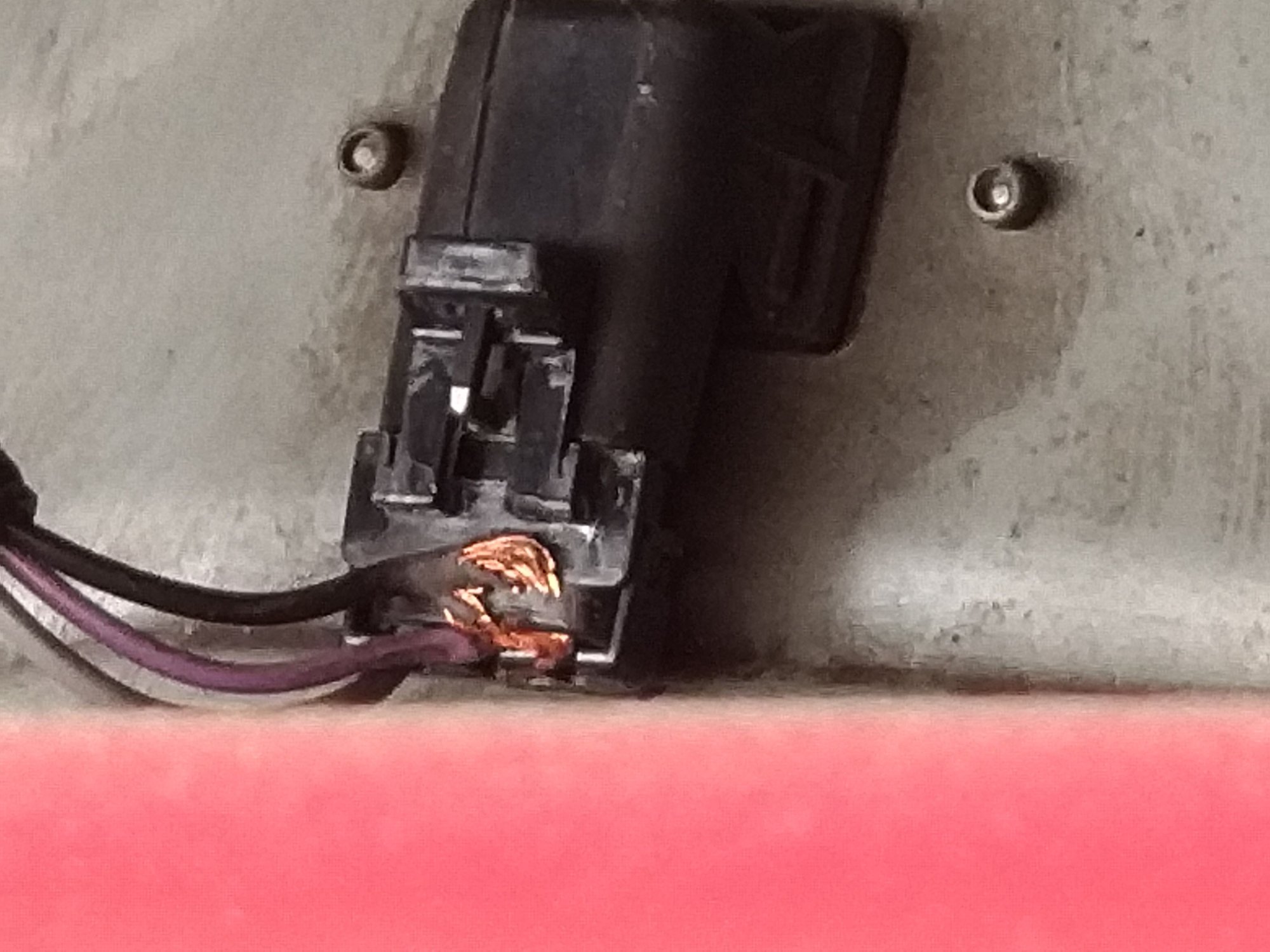

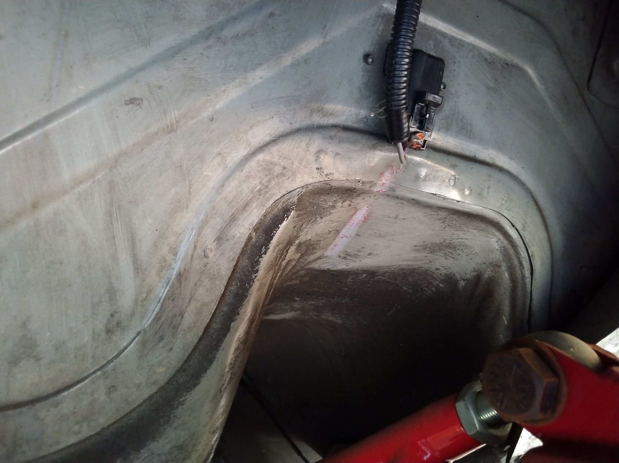

M9 hits fuel pump connector...
Just wanted to see if anyone else had seen this. The car does have drop springs but sits much higher with the m9. I think I may just need a BFH modification and to relocate the fuel pump connector.

Yep, I'd just relocate the connector and massage it a little bit.

what if you unbolt it and just flip the whole connector. so the wires are facing up and not down. that might give you enough room.

Have you double checked pinion angle? My 12 bolt hit the body when the pinion was nose high. The fab shop didn't check it after building a new torque arm for me (it was way off!). I adjusted pinion angle and never contacted the body again. Left a nice little dent though.
