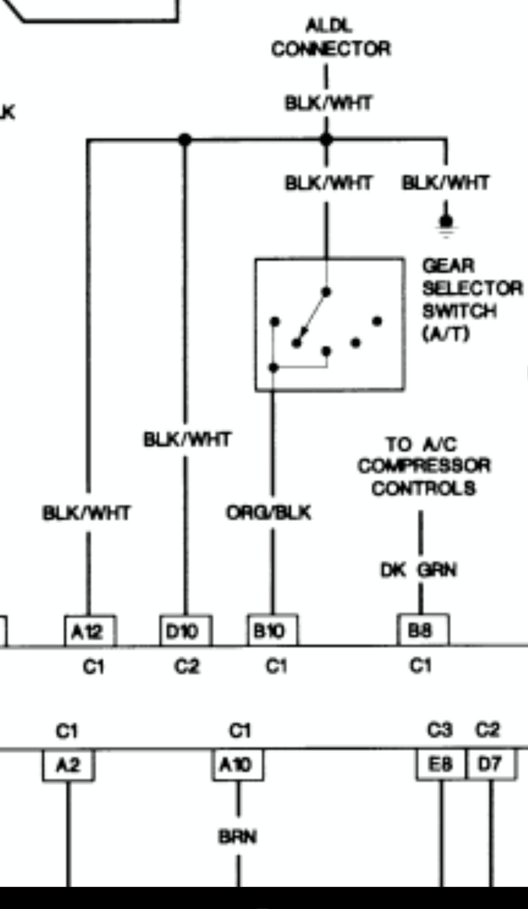

The only thing I can see from your picture is that orange wire with the black stripe looks like it goes to the steering column area where all those wires are cut.
It appears that it is cut also. Hard to tell though.

Wiring diagram shows that the ORG/BLK wire referenced above goes from the ECU to the Gear Selector Switch, which sounds about considering the context of this post. Will add more detail if I make any progress...
