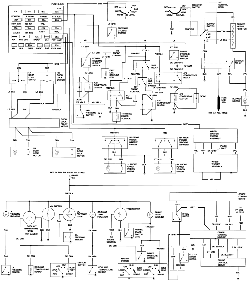

Problem number 2 : The owner before me have removed the AC system and the whole box on the firewall and installed one without the AC, but he has also cutted the whole harness for the power to the blowermotor and such cause hes been removing alot in the enginebay to make it look nice...... So i kinda need some wire diagram help to know what all the different coloured wires go so i can get my blower motor to work again

Here is your 1984 HVAC wiring , hopefully this helps you with your A/C wiring . As to the rear running lights , since you say the front ones work OK you might want to check the harness where it runs through the storage area in the left rear trunk area , if the cardboard compartment is missing things stored in that area can hit that harness .
