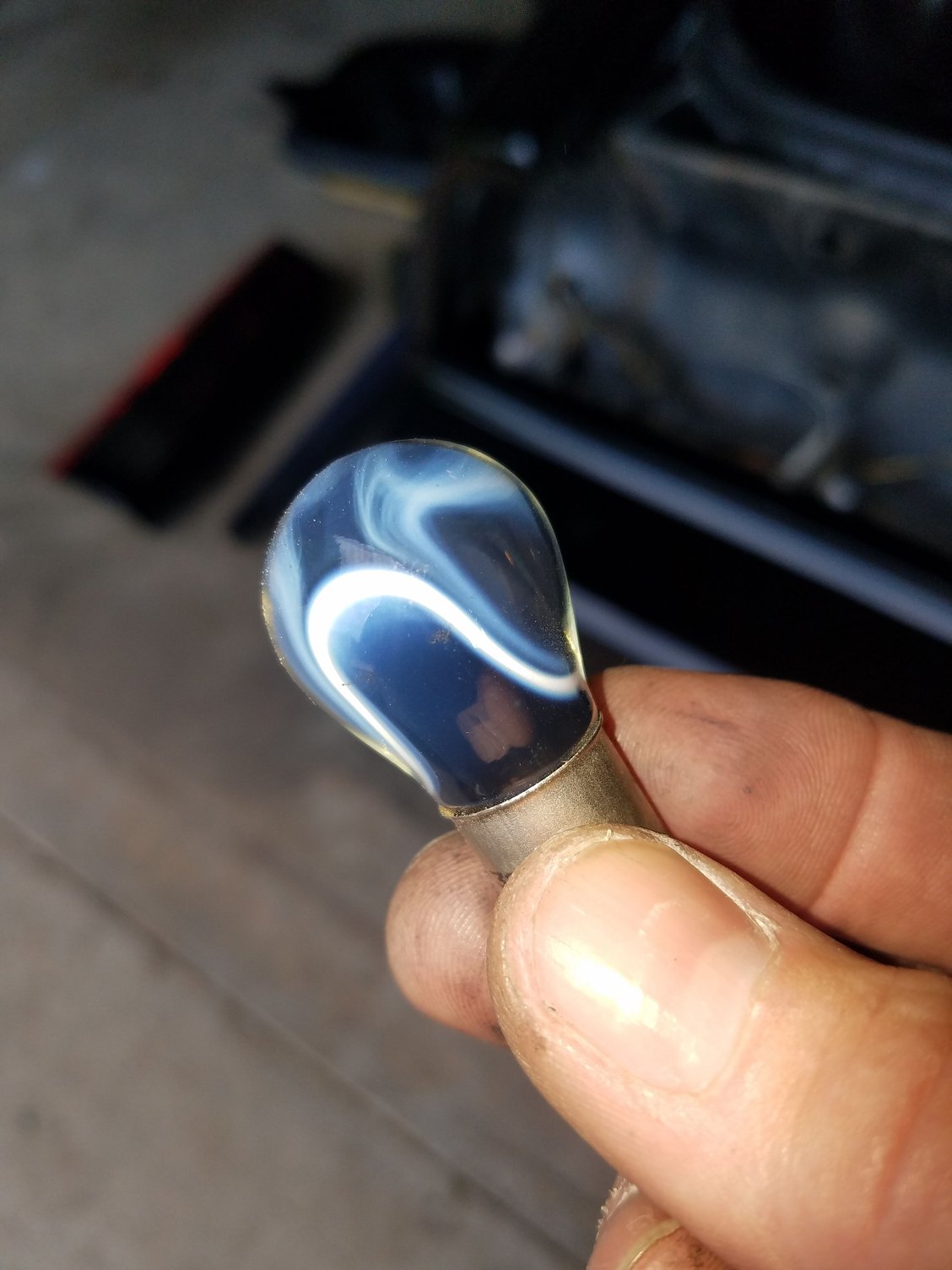

found the guilty culprit! Blow back up light!

As so often happens, sometimes the simplest explanation is the one most likely to be right. Even if it's not the first one you think of.
Glad you found it!!
