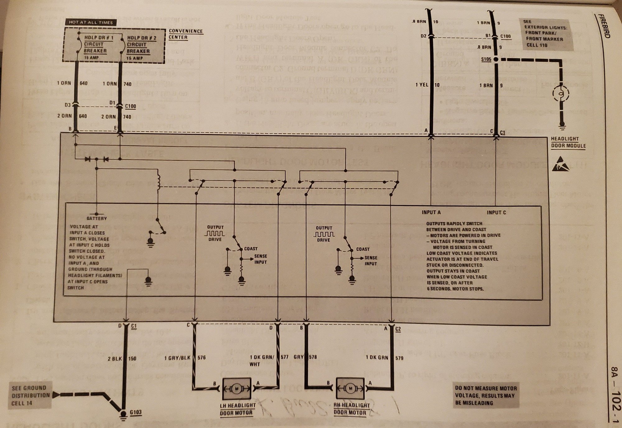

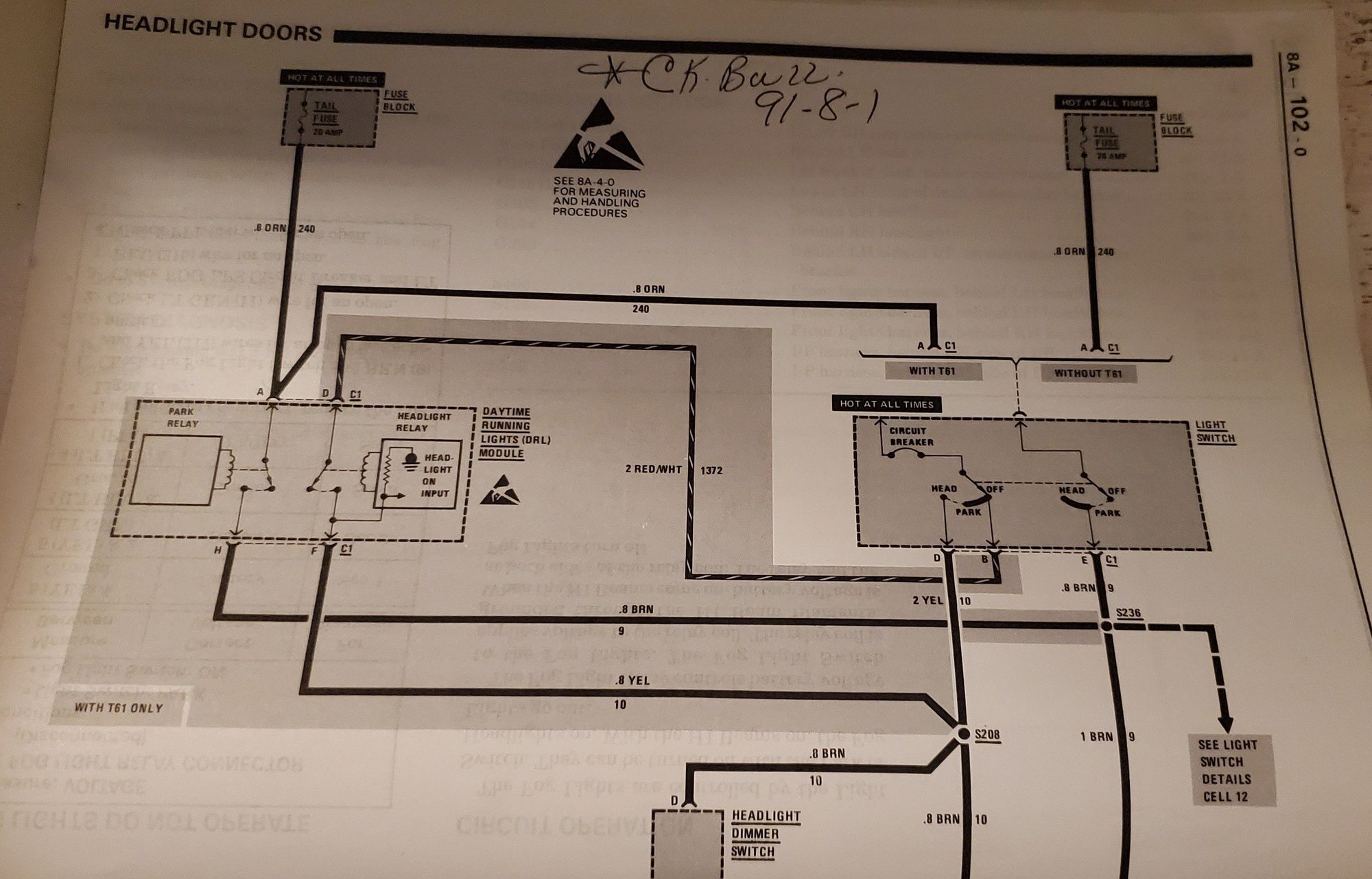

This is from the 90 service manual which should be the same as the 91, 92.
You will also want to make sure that the new module you put in is correct, 87-89 and 90+ had different control modules.
