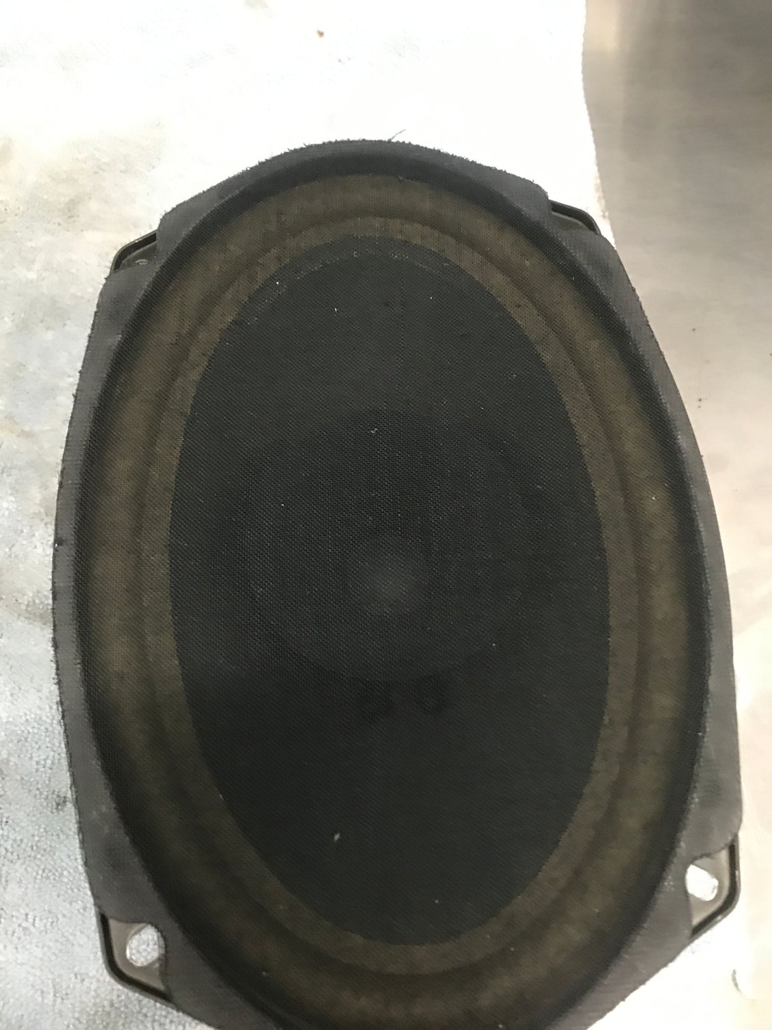

Original front speaker.
Replacement front speaker.
We have a problem. Different connector

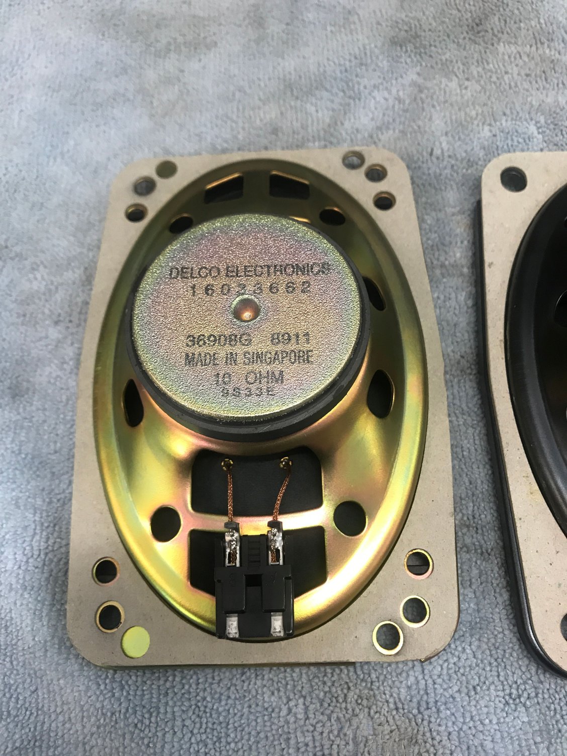

Factory rear speaker.
Replacement rear speaker.

Replacement speaker. With new connector. So I button everything up. Turn on the radio and within 1 minute my left front speaker blows. Argggggggghhhhhh!!

So, I was able to locate another NOS 10 Ohm Delco front speaker. It came in today and I put it in after work. Everything seems good to go.
Thanks guys! You taught me a thing or three in this thread.
And although I consider myself an originality **** and all that, if I have to do this again, I'm getting aftermarket speakers.

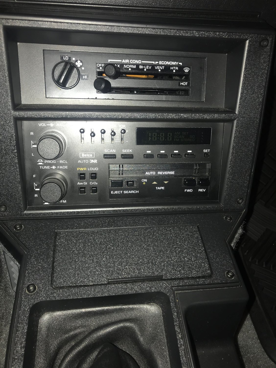

Update number 72!!! Got home early from work and decided to pull radio and hook up an Alpine unit I had on the shelf. All 4 speakers work. I already texted the radio guy and said I’m bringing my radio over this week.

Here we go, all buttoned up again. Apparently both DM 165 outputs were blown and needed replacing again. Radio guy theorizes that some feedback from the blown speakers did this. Who knows.
Lots of hassle just to get that '80's factory sound again. The sound was sooooooo much better from the Alpine unit I plugged in to test the speakers.
