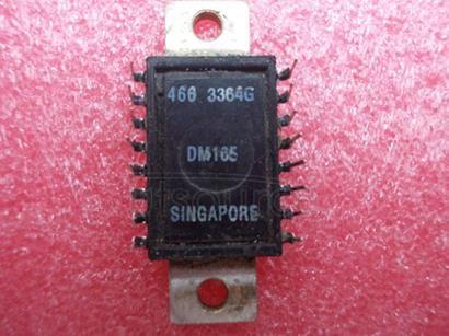

If the shop can't find the 'output IC' you need you can send me a picture of it (or the IC # such as DM165 or DM136 ) and I'll check to see if I have it.
I've got several good used DM165 (AKA "AMP") chips; when I replace bad capacitors on a head unit with bad speaker channels and the repair isn't successful ( because the DM165 chip on that side is dead or the board is bad ) I don't bother to replace the dead AMP chip,....... I remove the tested/good chip (usually the left ) and toss the AMP board in the trash.
Yup,..... the 25 or so AMP chips in that hardware drawer = about 25 or so dead radios that I've tossed !

I need 2 DM165s
Is this them? https://www.ebay.com/itm/2x-Texas-In...UAAOSwZ6VcSNJf

I do not know if the E-Bay chip is the same chip.........I've only used originals. The used chips I've got are $14 each; 2@ $25, and 3@$30; Shipping is $4.

Originally Posted by chazman
Those are not output ICs.
Check out this article: http://www.howtoalmanac.com/Scott/Ho...oAmpRepair.htm

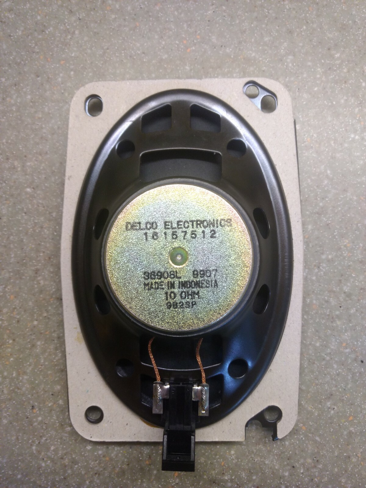

The stock speakers measure what? 10 ohms John?

10 OHMs in Front and 4 OHMs in Rear. (Lots of documentation says 4 OHMs for the rear; but I've found many cars with Delco 10 OHMs in the Rear too. )

Just so you know,..... the DM165 is a chip; It's the Capacitors that leak electrolyte.
Sounds like it's time to shop around for some new speakers ! Glad to hear the radio tech is going to get the 'tunes' playing in your ride again for Ya'.

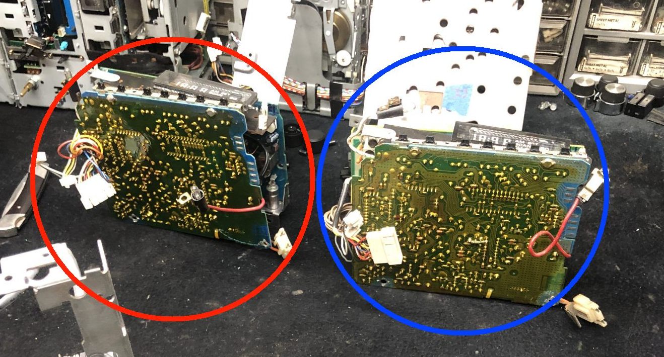

Any recommendations on speakers, John?
The irony is, that I almost never listen to the radio in this car, preferring the sound of the N10 exhaust.
BTW, these are the old parts.

Good to see he replaced the capacitors too,... should allow for a long life of good sound, you just never know when the originals are goin' to crap-out !

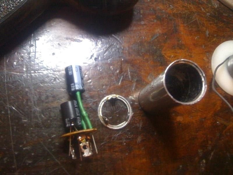

..... It's the Capacitors that leak electrolyte.......
Hi NoEmissions84TA , I'm curious why you think John's statement is funny , when electrolytic capacitors fail leaking electrolyte is one common visual cue .
Here is an internet picture of the internal workings of an electrolytic capacitor .......

Failed caps leaking electrolyte,... see it all the time.
I've got to wonder were the 4th green capacitor came from,.... there are only 3 "shorty" Caps located under the heat sink in every radio. ( leaking Caps killed the CHIP on this AMP board.
Well, I am an electronics technician, but this is a new one on me - I have never seen the caps of this style actually leak.
Some really, really old caps - yes. So I stand corrected.
Hi NoEmissions84TA , myself also , I have been into electronics restoration for over 50 years , I'm one of those old guys who keep the vacuum tube devices of the past functional in our modern times . I do cosmetic as well as electronic restoration and I'd like to show you a three section electrolytic capacitor that I rebuilt for my 14 tube 1947 Westinghouse radio (that has the modern FM band 88 to 108 MC) . When I've finished , the capacitor appears original but contains modern replacements in place of the dried out original internal structure .

Speakers are 4x6 front and 6x9 rear, right? 10 ohms or 8 ohms?

And front?
https://www.ebay.com/itm/GM-Delco-4x6-10-ohm-Chevrolet-Dash-Speaker-1-Speaker/224029830743?hash=item342937ee57:g:VgYAAOSwFpBe08Nm

The factory fronts are : 16033662
https://www.ebay.com/itm/1984-1987-C...YAAOSw4hldlU7R
This is what gets used for the front at reasonable cost: https://www.summitracing.com/parts/ado-15173233
The ones you posted might be from a Buick and are the same size & rated the same,... just not sure if the mounting holes are exact or the mounting depth.
The rear speakers you posted are not original; They will work, but 8 OHM is not original.
The GM PN I've got for the Thirdgen Camaro rear speaker is 16019120. You can see this speaker - and a bunch of other GM 4 OHM and 10 OHM rear 6x9's - in this thread:
https://www.thirdgen.org/forums/car-...-speakers.html
TINY magnet,... keep searching !!
