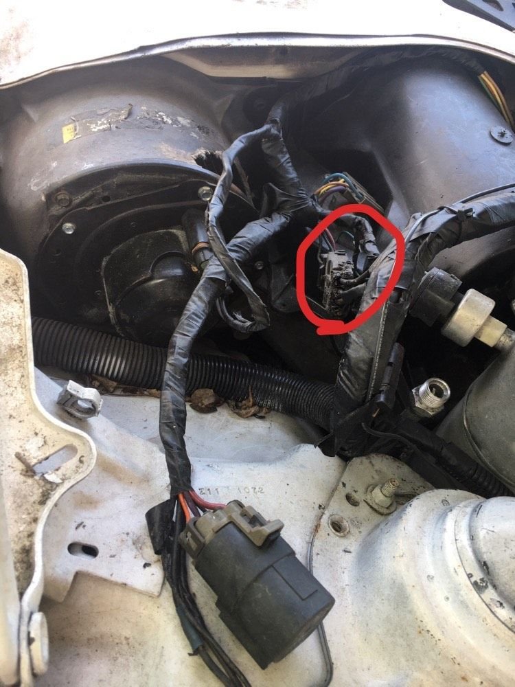

I'm starting to investigate the myriad of electrical problems my newly acquired '92 RS 305 5 speed, and I came across this melted plug near the blower motor. I know it needs a new blower motor and resistor, because it only works on high speed and screeches like a scalded pig, but I'd like to see if I can remedy whatever caused this melting. It looks like it burned the blower motor housing as well
Any ideas as to what it could be?

The blower connector is a cheap design, that's why it overheated.
Here's what I do: Solder wires to the blower motor and install a serious connector.
Then, of course I install a mating connector onto the harness.
RE: Screeching; It's either the motor, or the squirrel cage rubbing the inner housing.
You can remove the blower to determine.

Awesome thank you. I'll be pulling it all apart soon, time to find a new connector
