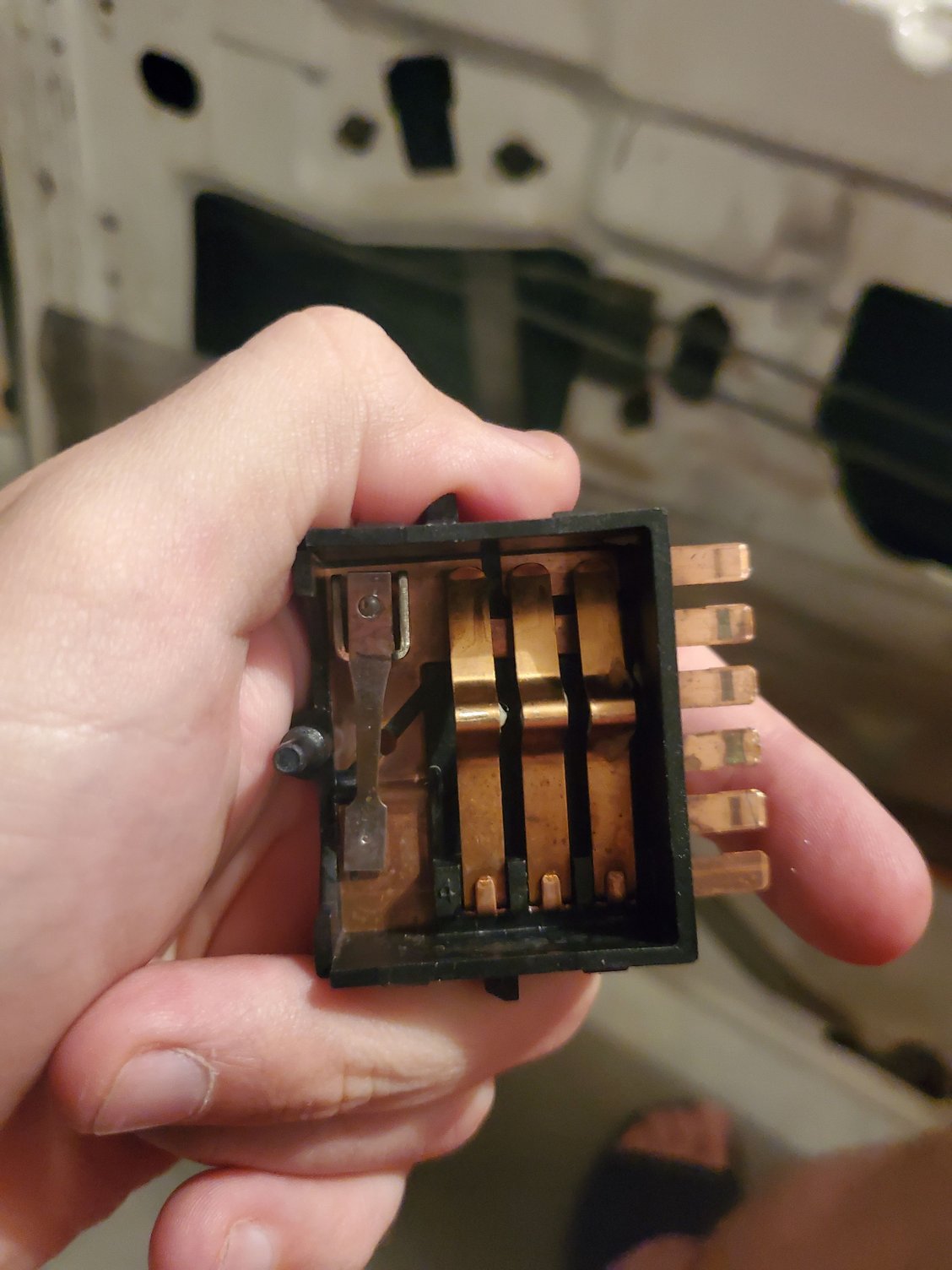

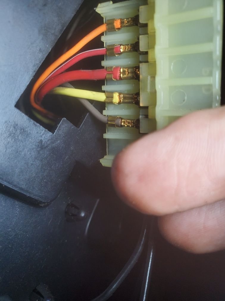

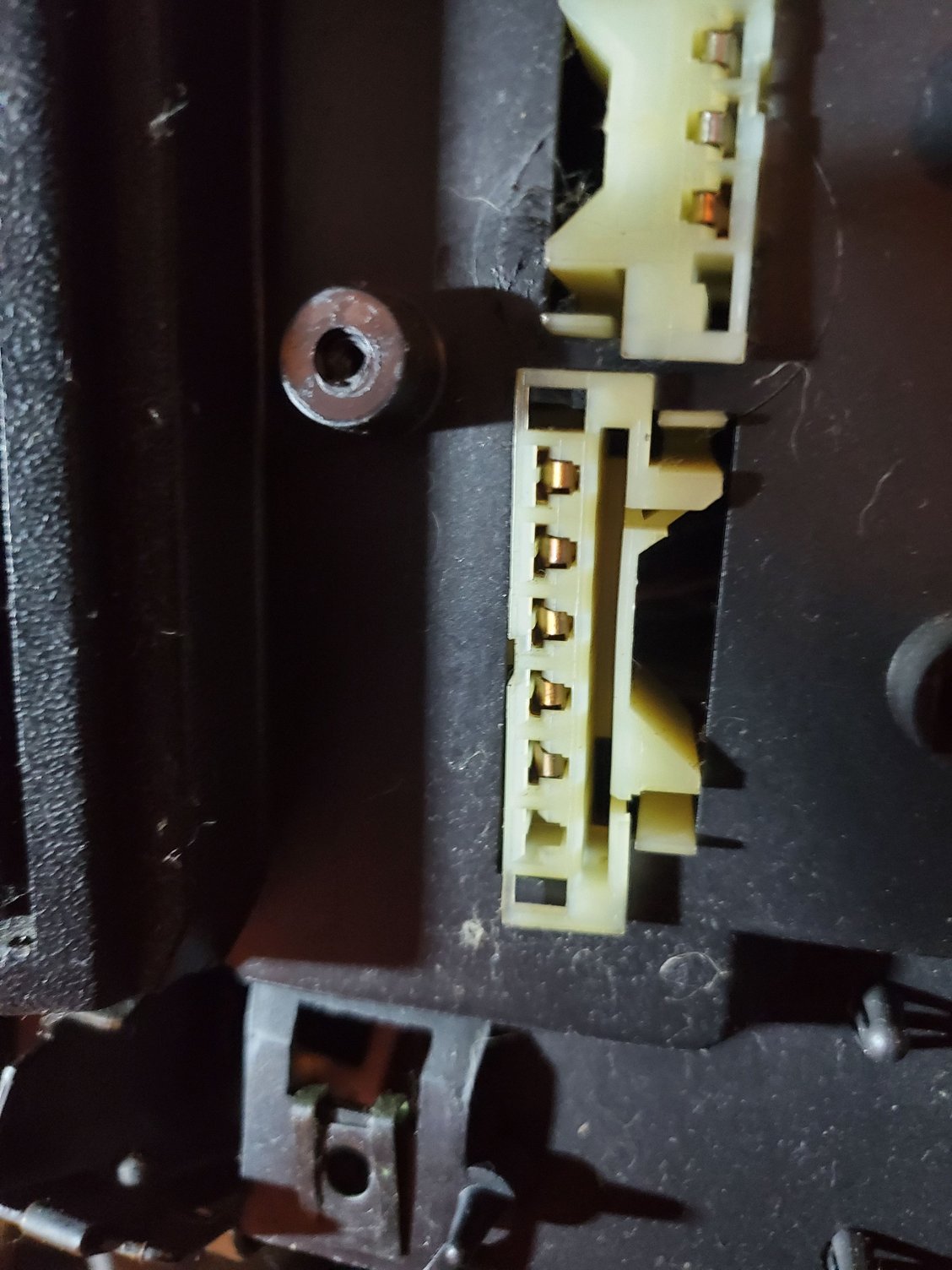

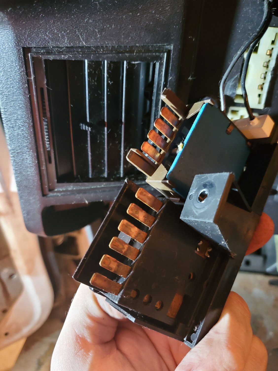

I'm currently dealing with a headlight problem. Unlike most trans ams my 1990 gta the headlights won't stay down. With the car off they close, and I have replaced the headlight switch and with the key off I can operate the on off and it responds. But when the car is on. They automatically come up.
I was trying to see about headlight module? Thats the middle one on the driver side near the firewall? I have a multimeter but not very good with it. If someone could recommend where to test things with it id apreciate it. My problem seems to be the opposite of others. The headlight switch in pics is the old one. Not sure if it matters at all for this, but the interior dimmer light scroll works...
