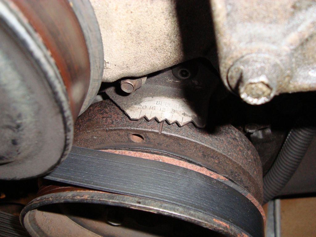

If the timing mark is down on the drivers side past the tab, that would be ATDC. It will crank and start, but the engine won't have any power. The correct timing is 10° BTDC. For the timing light pickup I like to use #4 cylinder, center drivers side. That way no need to drape the cable over the engine to get to #1.

IIRC, there are other marks/slots on the stock damper. You may be looking at the wrong one. The other possibility is that the damper is failing and the outer ring has moved. This puts the timing mark in the wrong spot, not at TDC.
Here is a picture of the tab with the timing mark at 11° BTDC:
RBob.
Thank you for the reply, Yes that is the Slit i was referring to. I am on the way to the shop now for further inspection of the car. I have one other question
