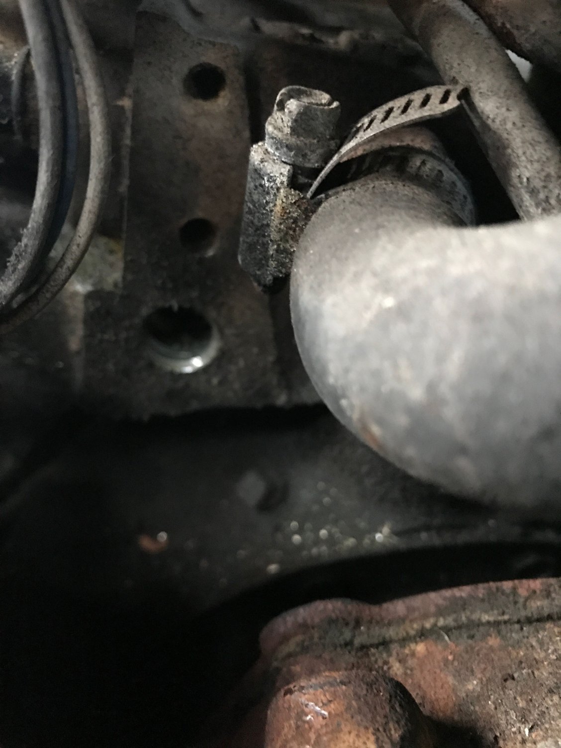

What sensor is this?
Accidentally took this sensor out thinking it was the coolant sensor which is actually to the right of this sensor. What is this sensor? I’m going to need to buy a new one plz help

Cold start injector timer switch. You can just plug it and get updated programming if 86-88 tpi.
or inquire in the classifieds wanted. Is no longer available by Bosch and insane price at ricks camaro
